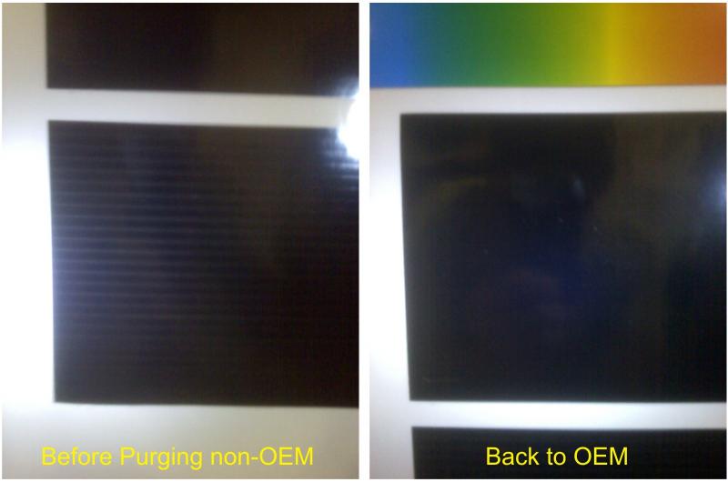

OK so history:
I switched to a non-OEM inkset for my OCE CS6060 (aka seiko CP64, aka HP9000) - a few months later I started having really bad banding, overspray, nozzle clogs, etc...changed dampers, captops, pump tube, switched heads around, etc etc...
Finally decided to purge and try OEM again...emptied sub-tank of black by running the pump in reverse, refilled with OEM black, and made a 40" x 5" sqare of pure K to purge the lines...first print you see the remaining non-OEM ink getting used up, second print directly after it using same exact file, not ripped again, just resent, and black has IMMEDIATELY cleared up...
I hate paying twice as much as before, but daaaamn dont think I will be spending countless hours cleaning grunting getting all 'inky' anymore...back to OEM for me...

When you first switched to non-OEM, did you build a custom profile with that ink? Doesn't seem like a fair test unless saturation limits have been taken into account. It could be that the non-OEM ink just needed far less to get the same saturation, and using an OEM profile had it spit out way too much ink, leading to over-saturation and clogging, among other possible problems.
