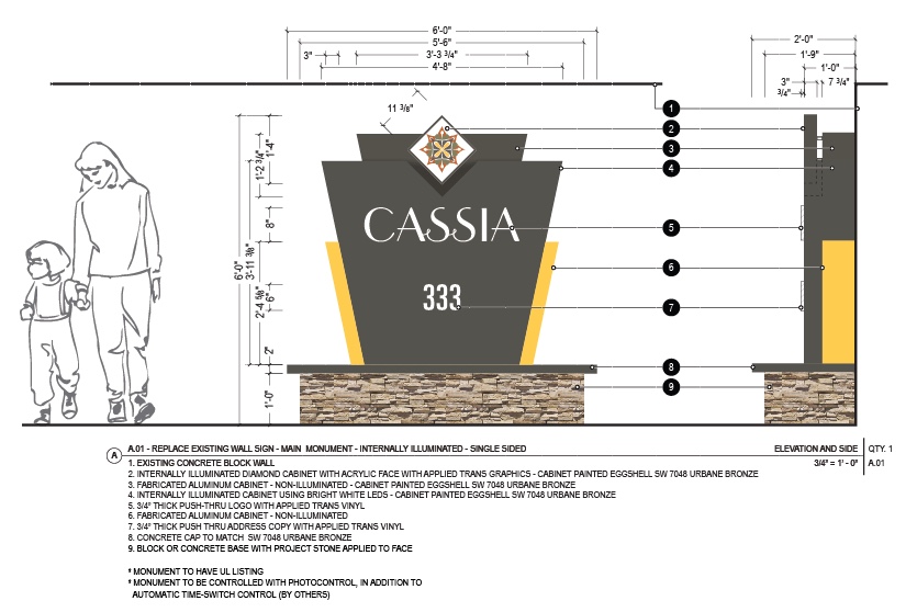

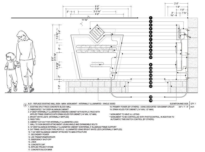

What type of signs are your designing/presenting?
How much detail do you need?
I use Hotdoor's CADTools in Illustrator - Shown is what I may show on the second round and final to permit. If all you need is overall size - this may be overkill - Flexi - as quirky as it is might be the cheapest alternative. That script doe snot make the best presentations, what's nice about CADtools compared to other options is how customizable it is and works within Illy.
if you have Corel, I know a few designers who design in Illustrator and do their dimensioning in CorelDraw.
