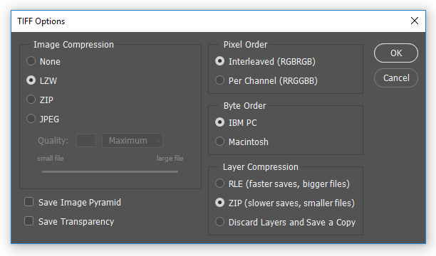

Make sure when saving as tiff that "Alpha Channels" is unchecked. I've had tiffs sent from a third party come up garbled in our Print RIP. Opened the file up in photoshop, resaved without Alpha Channels and all was good.
shoresigns
tried unchecking those and same thing. File corrupted when trying ot load into versa.
I haven't come across anything else in TIFF files that causes problems with Versaworks, but here's a screenshot of the exact settings we use here. If this still doesn't work, I'd be interested in taking a look at your file.
