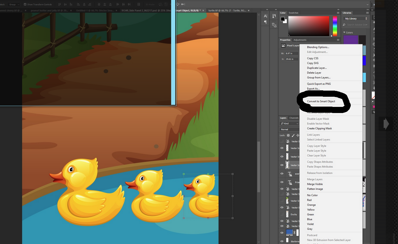

Am I missing it somewhere? Here is a screenshot with right click.

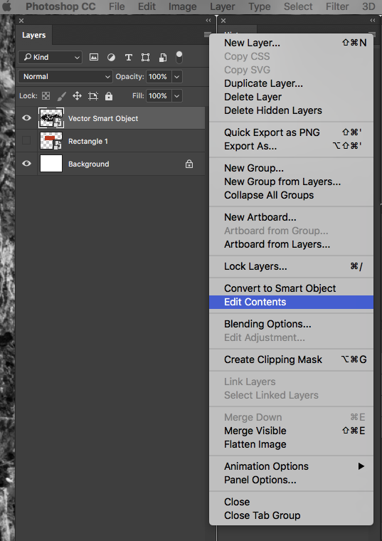

Chris...
you have to click on the layers drop down menu with the layer selected. It will edit in the original program it was created.

Are you sure you are on the right layer and/or that it truly is a "smart object"?

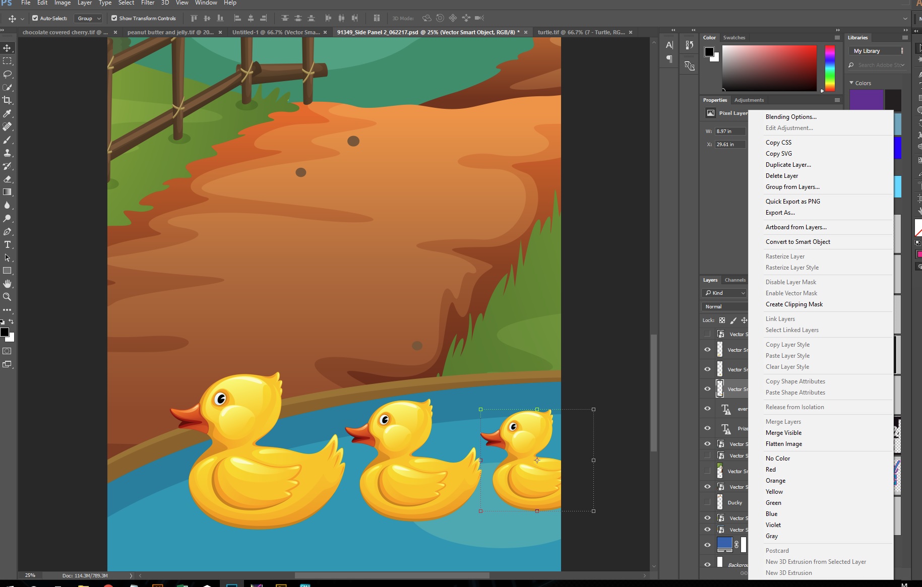

crny1
Its labeled vector smart object......It is labeled like that from PS. Not from me naming it. I have no idea if it was originally brought in from Illy. I was sent the PS file and its no where near correct and needs work. PSD is the only file the client has.

Technically, one can name it anything that they want.
The layer thumbnail is squished, but I don't see the normal icon that is normally left with a layer that has a "smart object" in it, so between the fact that it's asking if you "want to convert to a smart object" and no icon, I don't really think that it has a "smart object" in it.
If the design already needs extensive re-work, that would further support that.

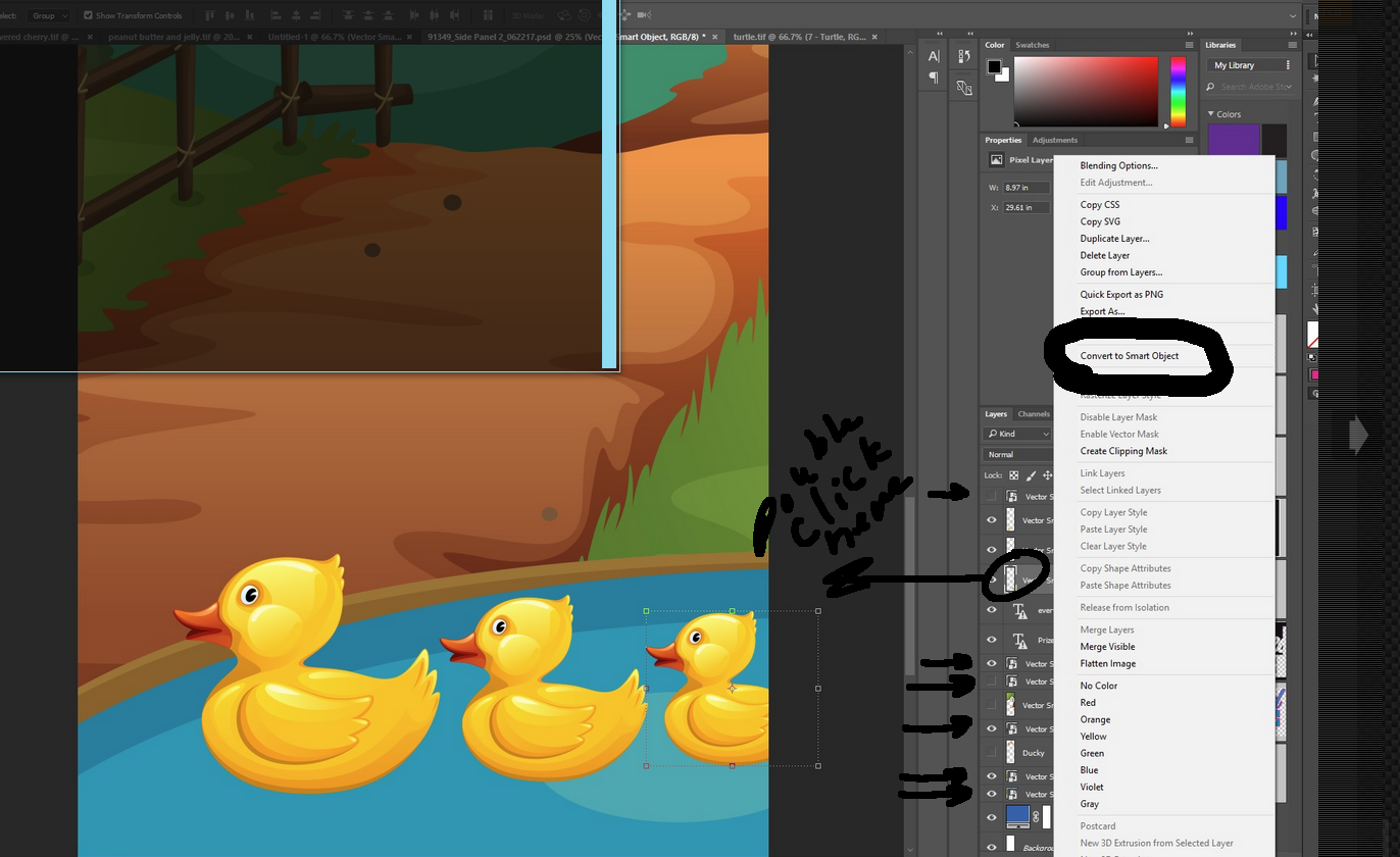

To the OP: The areas with the arrow have the icons that I would look for that have "smart objects" in them. The one that is highlighted does not.
Also, if they do have "smart objects" you should be able to double click the area that is circled and you'll get a notice about saving any changes done or something along those lines and Ai should then open up to the "smart object" in question.

To me, it looks like they rasterized a Smart Object and it left "Smart Object" as the name of the new, rasterized layer. I did see a few actual smart objects in the layers. One of them may be an actual vector smart object and you may be able to work with them.
WildWestDesigns
It looks like there were 6 "smart objects" (based on the icons by the preview thumbnails in the layers panel), but the highlighted layer was not one. It could have been accidentally (or on purpose) rasterized, I dunno, but the reason why all the options aren't coming up for that one layer as it isn't a "smart object" now, regardless if it was one before.
