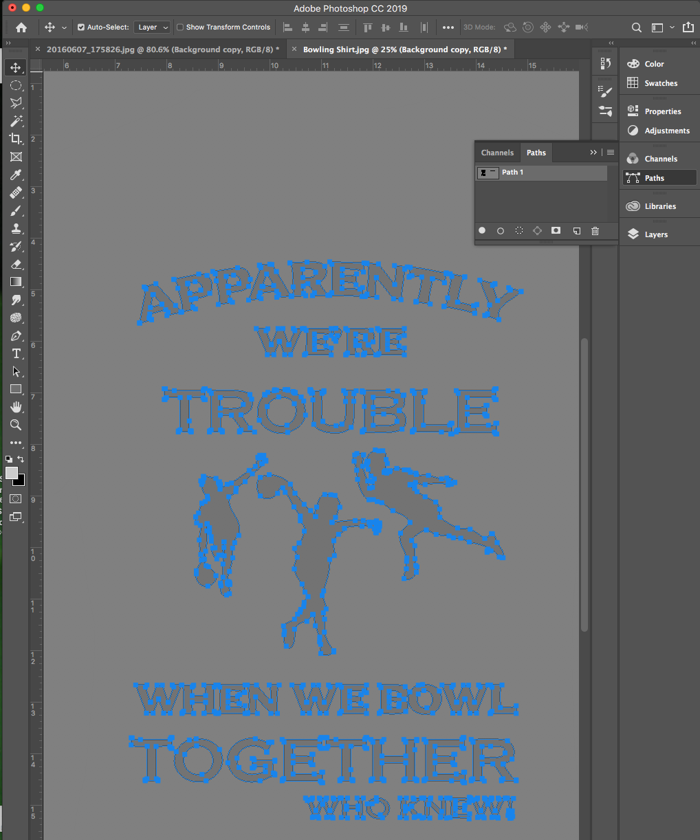

SheBeau
Or select what you want contour cut in PS. Save as Path/Clipping Path, then export path to AI.
