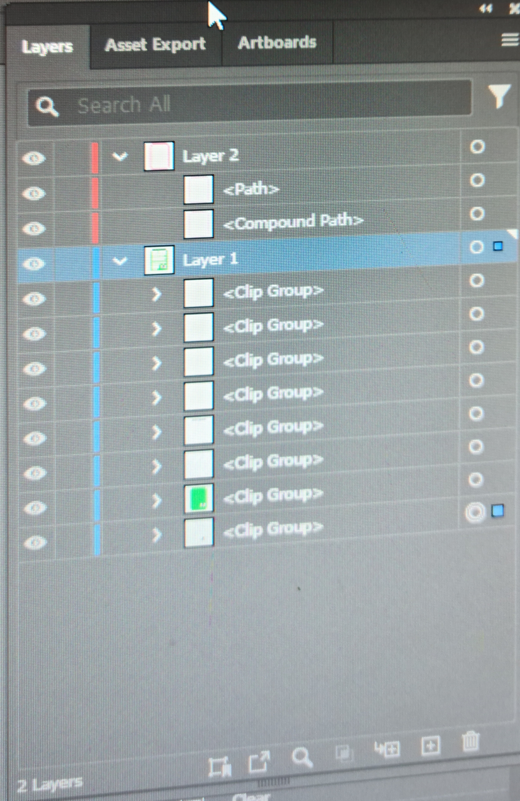

A designer has made a graphic and saved as pdf from photoshop
It shows as a clipped group and all are masked within the group
It shows the layers and paths but it won't let me offset path
I'm struggling to make cut lines, how do I convert the pdf to ai?
swarnes
I have attached issue that they are all clipped in group so I can't do offset path on outside path

You should be able see each element in the group and choose the element you want to offset it's path or is it raster data?
swarnes
Ok I just tried clicking the edge of the shape and offset path it does not work can I send you the file to look please?

Those are a pain in the... If you expand all the layers you'll find the shape files for each clip group. If yer' lucky you can duplicate just the clip shapes into a separate layer, combine them and use that to make your cut shape file. Then save it as an AI or EPS.

For me, this is probably one of, if not THE most annoying parts of turning customer designs into production files. But there are relatively easy ways to handle it.
Any time illustrator opens a PDF created by another program, you're going to have Clip Groups (clipping masks that are really just containers for grouping stuff together.) Sometimes those paths can just be deleted without breaking the design.
If I get artwork that needs contour cut like a sticker and it's a complex layers situation, I'll just scale the design to what I need, copy it, then rasterize it, then do a live trace so I can get a shape very close to the shape I need to cut out. Usually the "silhouette" trace preset works the best for me. I'm not looking for interior details here, I want the overall shape of the design as one solid filled object. I still might have to adjust the threshold, points, corners, noise etc, but I use this method a lot. The end result may still need cleaned up a little, but it's often easier for me to do it this way than digging through a bunch of layers or creating the path manually with the pen tool.
Of course this also works for plain raster images. You can just skip the rasterize step. Just remember to copy the original art before you trace it, then paste it in place and send to the back so you can check the accuracy of the new path and adjust any points as needed.
Once I have the contour shape, I'll apply the offset path as needed.
After you click on it, when you have the shape selected, copy it. Make sure it's the whole shape and not just a line segment from the direct selection tool.
Deselect everything then paste in place. You can put it on it's own later if you want just keep it aligned with the original. Assign a solid fill color and expand the shape.
Now it should be a regular vector object you can manipulate. Assuming the shape you are clicking on from the start is vector data.
