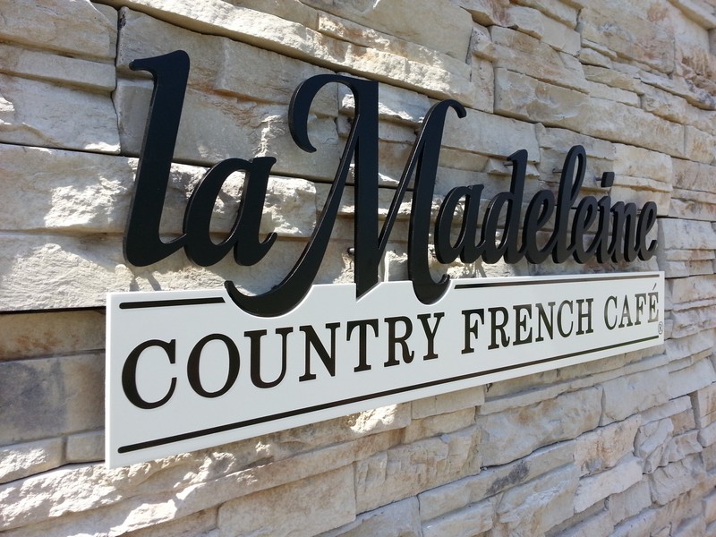

You have got to post a pic of what your doing. This customer wanted individual letters on this stone but I said this would work a whole lot better
Similar application but a flat wall. These will be oval shaped panels indicating apartment numbers / directions. Based on comments above I have gone to a 3/4" thick panel. The architect has specified .5" aluminum until I broke the news about his budget.

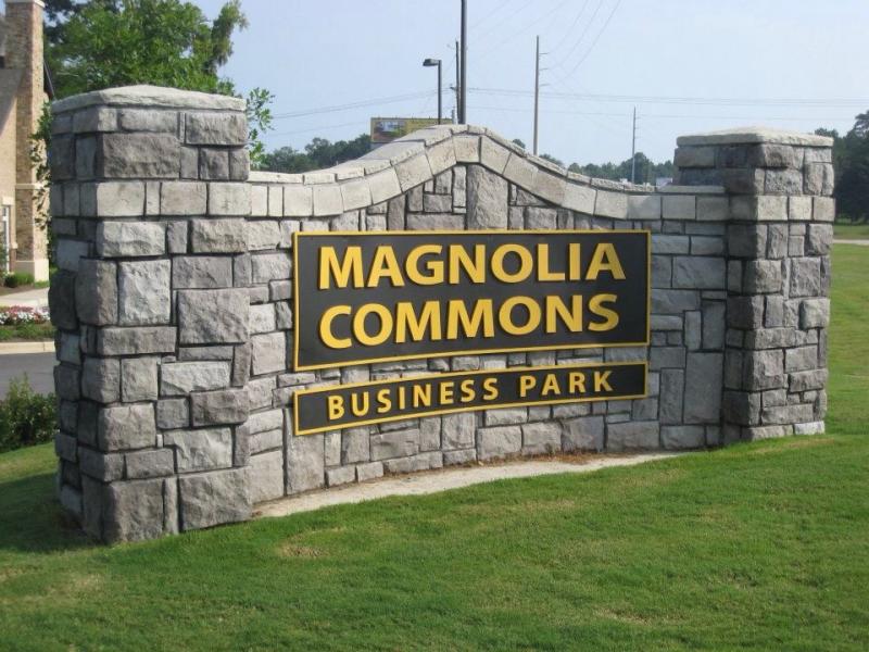

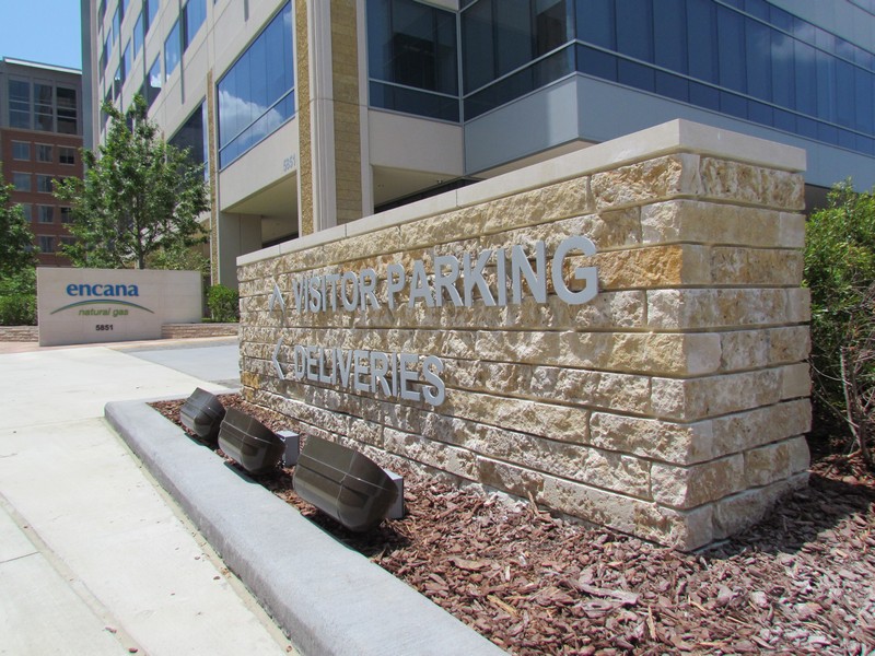

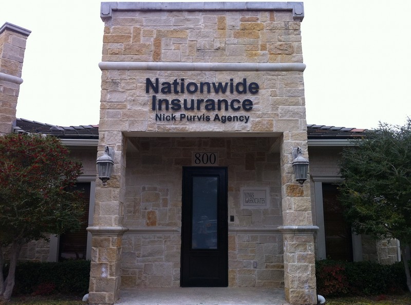

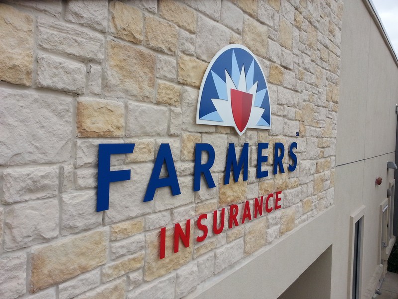

I did six sets of the Market Street letters and two sets of some of the others ones shown in the pictures below. There were two sets of the 'Parking' letters for the Encana job which totaled about 200 holes. I'd love to do 40 signs with 4 holes each s opposed to doing a ton of letters and having to make sure they're level, plumb and flush.
