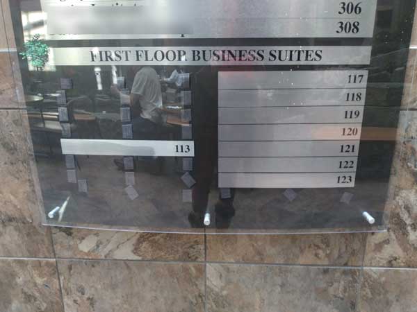

I need some more education on low energy plastics. Dealing with a failure on my sign from hell. Recently installed some smaller name plates made out of 1/16" engraving plastic sheet stock mounted with magnetic tape and you can see what happened. Half of them started falling off the board a few days ago. I checked out the backs of the larger name plates above done by another sign shop and it looks like they used some two sided tape to keep the magnets stuck on. I may try some vhb tape, but if that doesn't work, what kind of epoxy?

I was surprised too. The bigger plates above made by another shop are nearly 3ft wide and held with tiny pieces of magnetic tape stuck on every 6" or so and they've apparently held for years. Mine are smaller and lighter and fell off in less than a month. Figures.
gnubler
The magnets stayed on the sign and the plastic plates just fell on the ground. :p

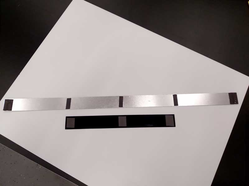

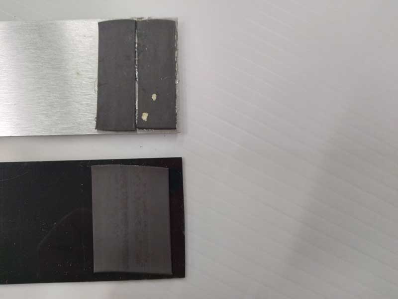

I stuck 3pcs of magnetic tape on mine, they are only about a foot wide. Here's some shots comparing the backs of the original aluminum plates with mine (black plastic). Looking closer it looks like whoever made the aluminum plates used some kind of epoxy on his magnets, I can see some residue. This must be my week for "low energy plastic" failure...dealt with it on the Yeti cooler decals also.
