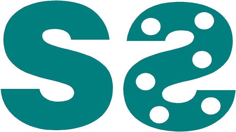

Example: We installed 36" letters on church. It took one month for those letters to pull themselves off drivit. warping and becoming disfugured.
I took them down cut the same letters in .063 aluminum and made pvc stand offs for back. Ripped all that crappy *** pvc off and place new letters. They have been up for about a years now (I think) and absolutely no issues at all.
Ill use 3/4" pvc up to about 15" if it outside. If its facing south Ill use aluminum with pvc stand offs. I make the stand offs a little smaller than the stroke of the letters so as they are not visible and the letter apears to be floating. Im glad this church job bit my *** cause It forced me to find another option for lettering.
