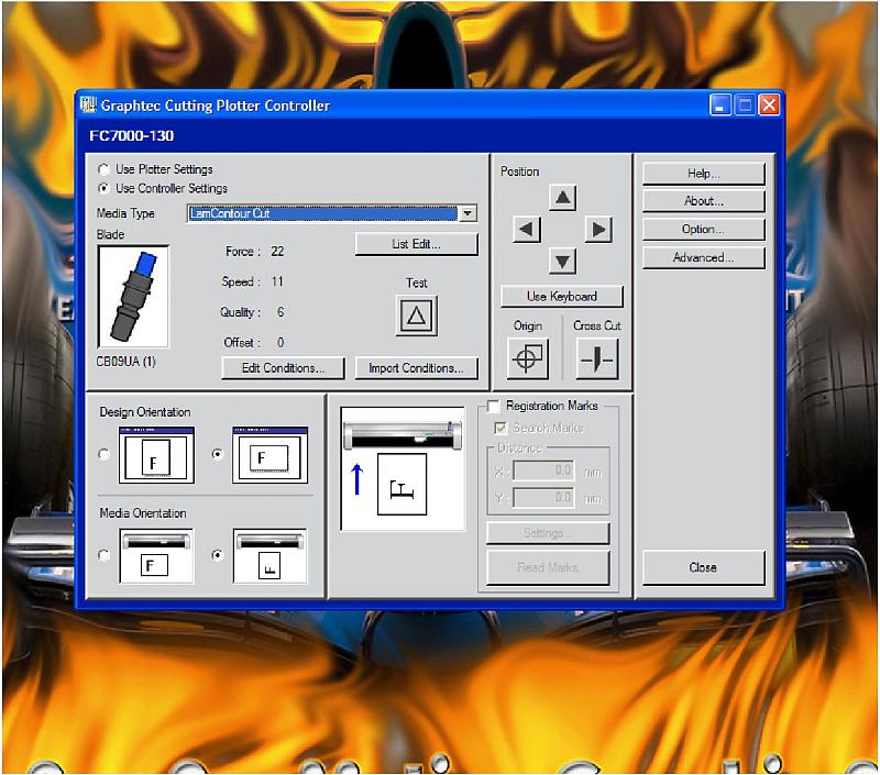

On my Graphtec it is all set by the Cutting Plotter Controller ,,I can set the force, speed and anything else i need from the software. I can even scroll the media from the software.

What VC is trying to find out is if the Q series comes with the controller or will work with the Graphtec controller so he dont haft to set the pressures and test cuts at the plotter,,he wants a controller like the Graphtecs do ....its all software driven .

Correct Matt.
The Q series can also be controlled via software using LXi. In the LXi production manager, on the Advanced tab, there is a Cutter Driver Options window. The default mode when you add any plotter setup is for the software to override the settings on the plotter's control panel so you don't have to enter them manually. The default preset in Production Manager is Cut Fast.
You can pick that one and accept those parameters, or adjust them individually. So you can control the force, speed and offset on the Q Series with the control panel (my preference) or using the Cutter Driver Options feature in LXi.
Hope that helps.

Will graphtec cutter plotter controller work on a q100?

The Q doesn't come with the Graphtec plug-ins. We use the LXi feature instead. I've not tried to use a Q with the Graphtec plug-ins, so I can't say wether it would work or not.
Generally, we advise people that, if you really want to use Cutting Master to work seamlessly from CorelDRAW or Illustrator, buy a Graphtec. If you don't already know your way around CorelDRAW or Illustrator and want to get a quick start with software that's easy to learn, buy the Q with LXi (or a Graphtec with LXi) and shorten the learning curve.
