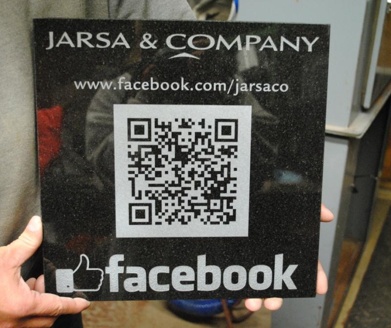

As stated on an earlier post, we're doing a business expo on Saturday and wanted something with a little pizazz to set our business cards on that would leave a leave a lasting impression with potential clients.
Granite tile measures 12" x 12", and the image is sandblast etched into the stone.
Our logo and the facbook logo were stenciled using Hartco 310 (10 mil) and the QR code was stenciled with Ikonics RapidMask (4 mil polymer photoresist).
Give it a few years and you'll probably be seeing QR codes on headstones.
Thanks to 2NinerNiner2 for verifying that my QR code works.
JB

Out of curiosity, I took the granite tile to the local AT&T store this afternoon to see if it worked with a smart phone. Sure enough, the phone locked onto the code instantly and it went right to my link. I had concerns that possible reflection from the stone might impede the phone's abilities.
JB
