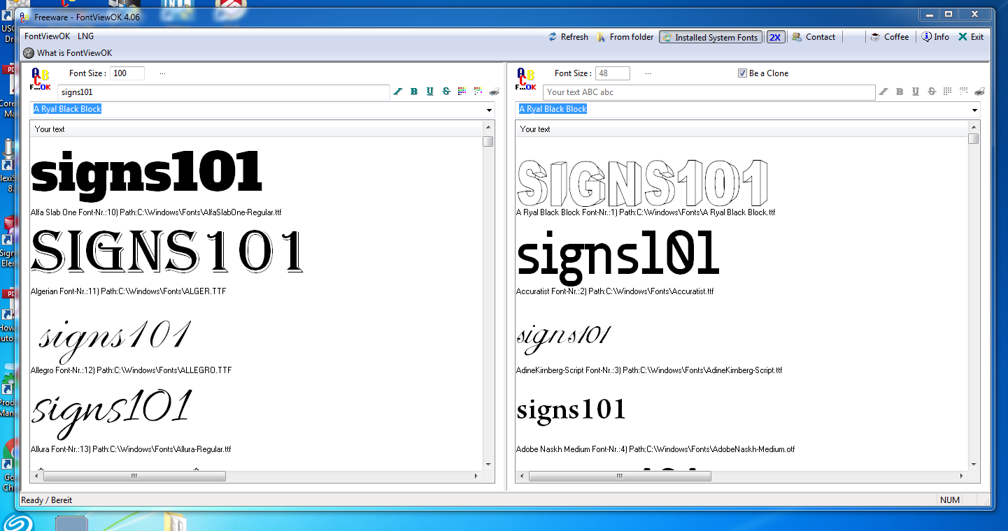

I like this tiny program called fontview OK- it wont organize them, but you can view them and its free.
I'll see if I can upload it - its 152K or send a message if you want it. Some sites that have it have a bunch of ads.
