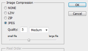

the easiest shortcut for your problem is to work with the image inside the files without embedding it, this way allow you to use the image like a "place holder" where you use the image you want but at a low-quality then when everything in place.. just change to original quality. i do it all the time.
see the example below:
the original image is about 22mb, i load it in adobe ps, when save it as TIFF the following dialog appear (i'm using ps cs5)
now notice the file size difference:
now as long as the images is linked NOT embedded, this way work fine. at the end of your project you change the image files in the folder to the original files, update the file and you are done.
note: i never used this method to a file higher than 1.2gb.
