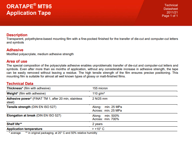

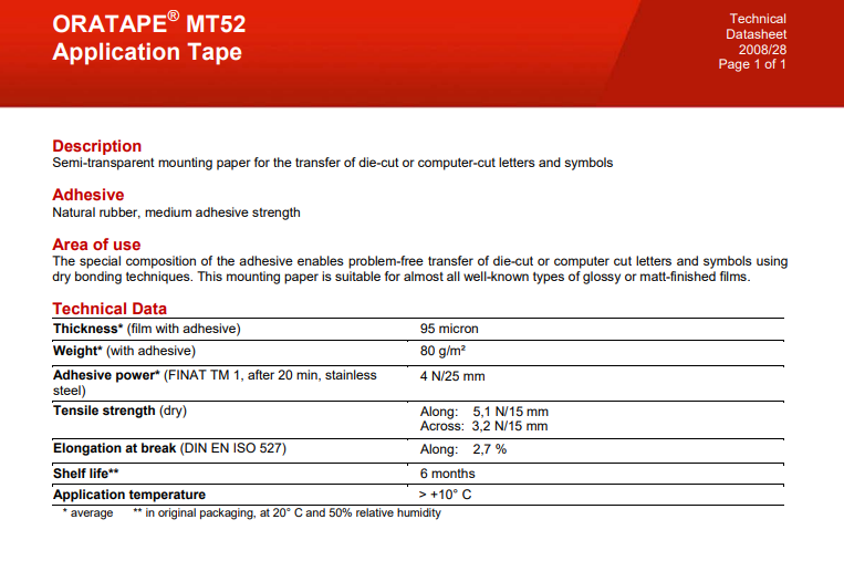

I try to find best transfer tape, that will suit vinyl I am working with right now (Ritrama Platinum). First, I don`t understand the specs here.
According to data sheet, Oratape MT52 (paper) has adhesive power of 4 N/25 mm, but Oratape MT95 (tape) has adhesive power 2 N/25 mm. I have them both and it`s clear to me, that tape has stronger adhesive than paper. What with the specs then?
Also, If someone could advise low tack transfer tape or paper, that can be bought in EU for my vinyl, I would appreciate.
