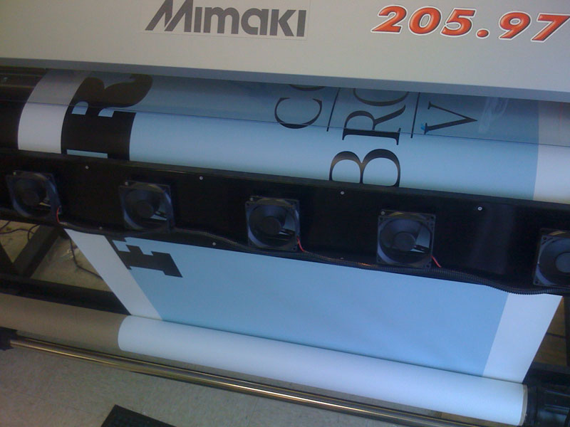

Colorado, I used to have that exact problem. There are a lot of dryer options out there, but we made our own using case fans and a powersupply from a dead pc. Total cost was about 40 bucks. I can print at 6 passes bi directional without prints sticking together anymore. Made a HUGE difference.
oh, sorry to be a thread priate... I know this started about waste, but if he isnt having to stop every 30 feet, maybe it still is :)
