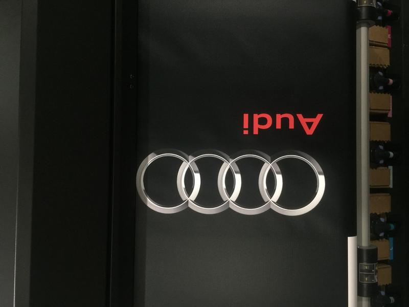

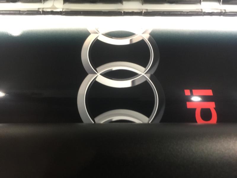

Can you post a pic of the samples that you got???? I'm curious to see what they look like
This banner was printed at 8pass
