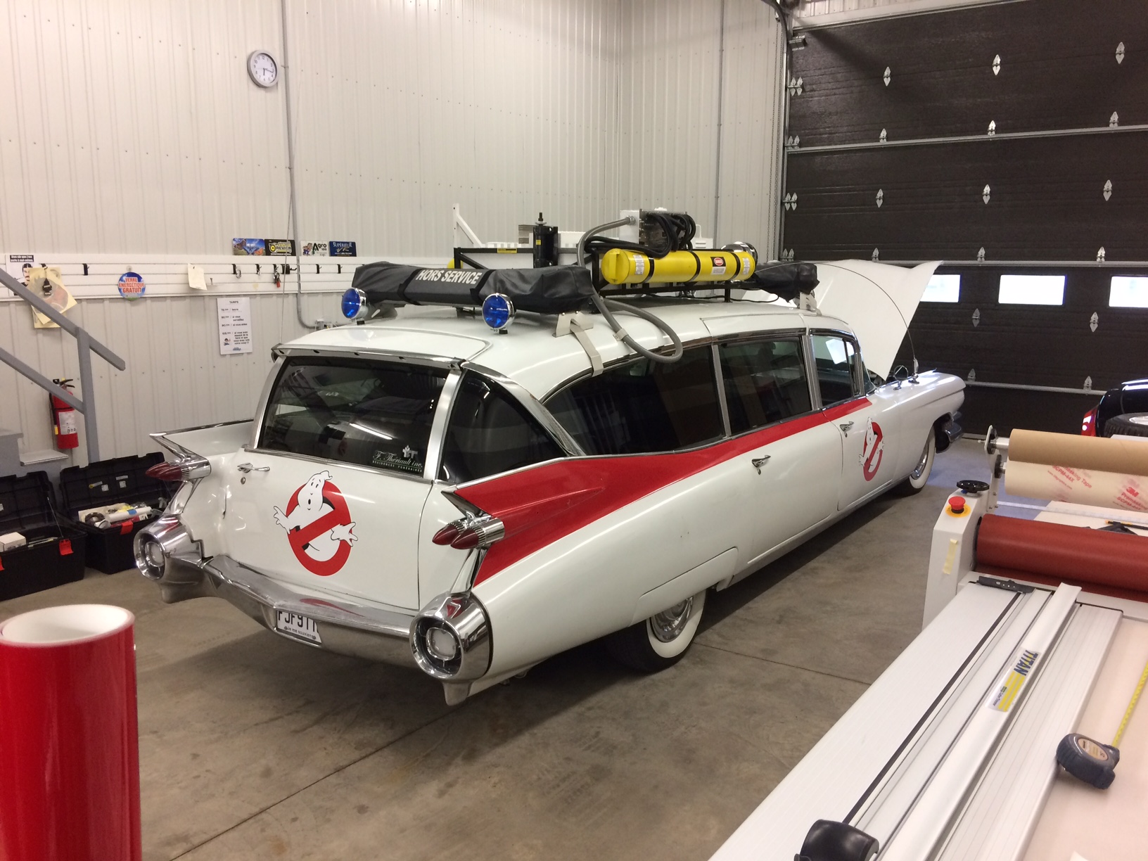

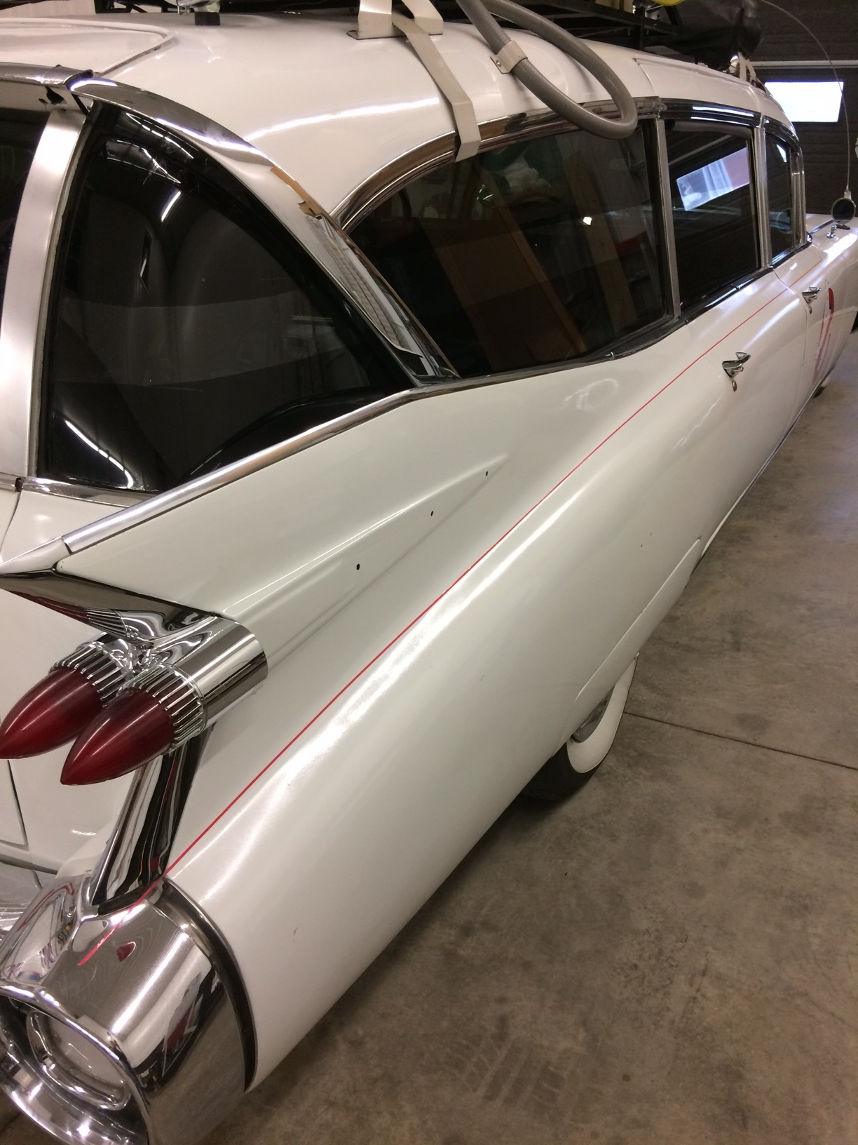

Today I have an old lady in the shop but a famous one. The owner ask me to wrap the red sections with new film (we have selected Avery Gloss Carmine Red)

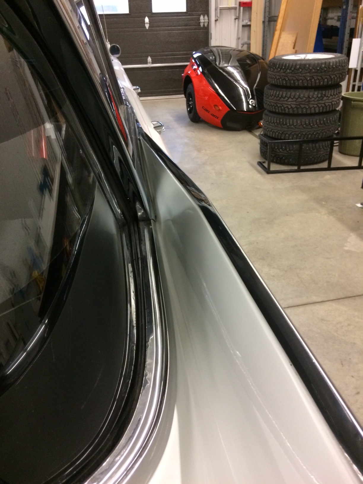

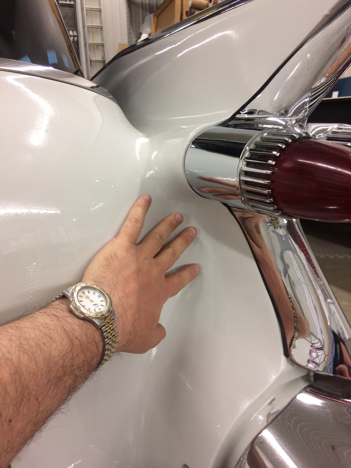

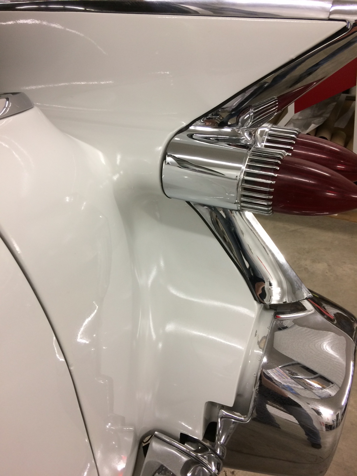

The exterior (rear quarter panels - doors) are pretty simple but he wants the inside of rear fenders done (which weren't done on this replica). As the car is very old, parts no longer available, all chrome trims could not be pulled off. Same for side glasses. I have to deal with it but there's few spots where neither my fingers nor the squeegee will make it. There's also a pretty tricky portion inside the rear lights where it's concave spot I just don't know how to work it on.
Any advice? Can it be done in 1 piece? Are few splices acceptable?

Your concave area looks to be a tough spot. Seams are an acceptable means as well as adhesion promoter. I personally am a minimalist when it comes to promoter.
Try to hide seam on natural body lines.
For the tight spot you mentioned, you have to be able to apply pressure to your vinyl. So any of those areas that you can't get to, can't be wrapped.

As far as the tight spots, you may have to order some tools from www.44tools.com to reach the areas where you can't get your hand or squeegee into. You can also put a buffer or velcro on a flexible putty knife from your local hardware store (plastic or flexible steel).

You gonna have some hectic difficulty there. I would say make sure the customer knows that they are not gonna get a perfect job. Pre-warn them they they cannot expect a perfect paint finish. Do it with some inlays. In that concave section, i reckon some clever pre-stretching before application to create a pocket could work well, limiting the tension in that area.
