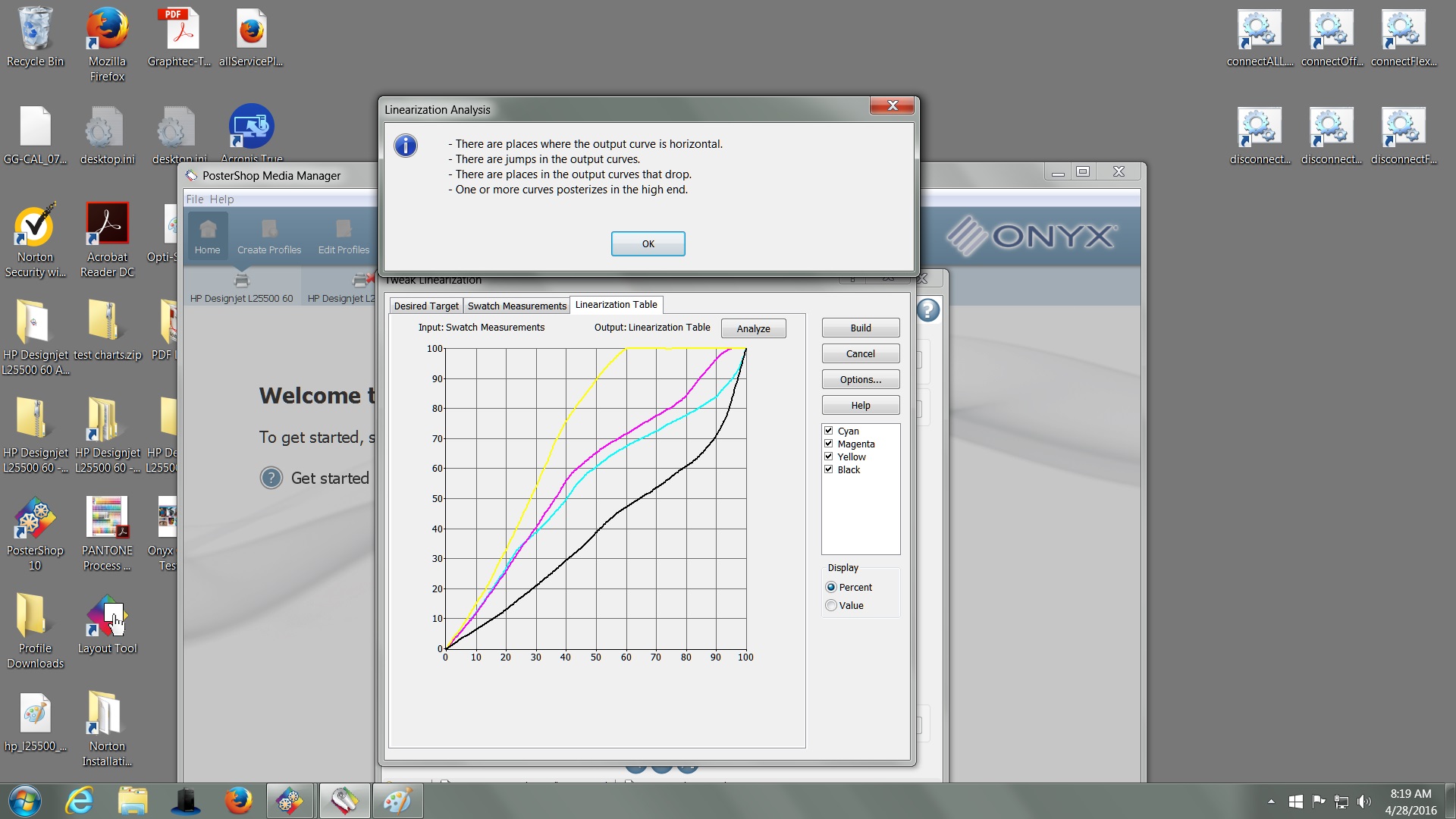

I posted this question on Friday but could not find it again to reply with images of the problem I am having with my HP L25500 not printing the correct colors. After running a recalibration in Onyx 10 I received messages about what is wrong, but do not see any explanation on how to fix the problems. I am attaching the messages in this post. Any help is greatly appreciated. Thank you.

4 possibilities come to mind - you have a linearization already in place that is corrupted, your reading device is not calibrated or just toast, your N factor on yellow is wrong, or your printer is dumping yellow from some mechanical issue. not enough info in your post to really sort out the issue. the K channel looks like its already linearized, the CM look like theyre unlinearized. but the big plateau and rapid climb in Y is whack. if you have the N factor set wonky it might do this. (?)
NO WAY thats a real world thing so something is broke...
I'd start over and build a new media from scratch. the messages arent really a diagnosis, more a warning that there are spikes, etc in the print that shouldnt be there..

OK.....not sure I know how to build a new media from scratch, sorry. I did recalibrate today and changed the N factor on the yellow from 5 to 2 and received a message that all was correct. When I printed a file to check color against the customer's current logo color, it was still way off.
