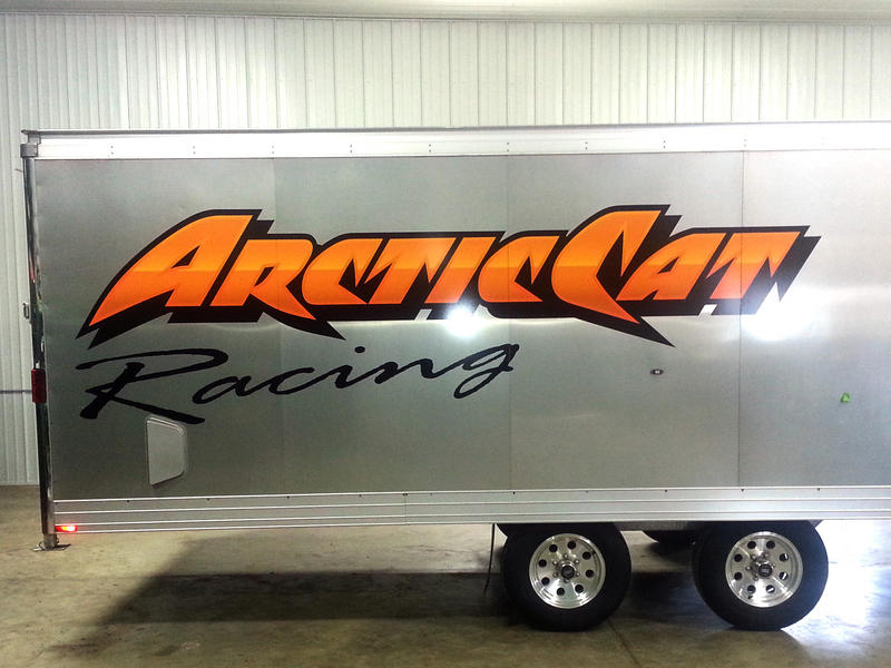

I just installed these today on a friend's snowmobile trailer with 3M IJ180. They were 155" x 30" and I center hinged them and applied them with the use of a helper. Fortunately there were no rivets and it took about a half hour to clean and a half hour to install. I could have done it myself using magnets had it not been an aluminum surface, but regardless, two is better than one in these situations.

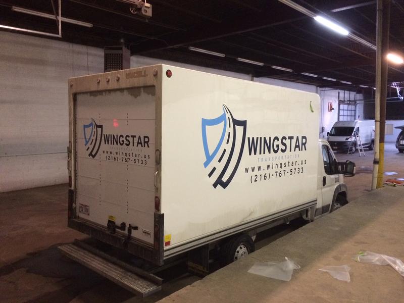

Dennis422
This one went pretty easy. With help is no problem.
Luckily, there were no rivets involved. Out of 13 trucks that get these big decals, 10 of them do not have rivets. (Only a few on the back roll up door)

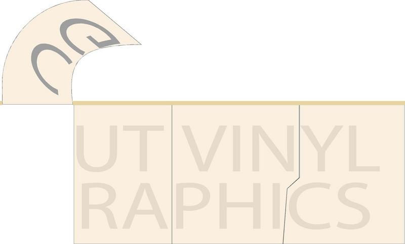

Guess I didn't realize it was cut vinyl...in that case you CAN tape a hinge horizontally across the top, then cut vertical strips and lay pieces at a time. This is especially beneficial if you only have one set of hands installing a big graphic. Obviously, this won't work for a large decal, or any cut vinyl with a long horizontal piece in it that can't be cut.
