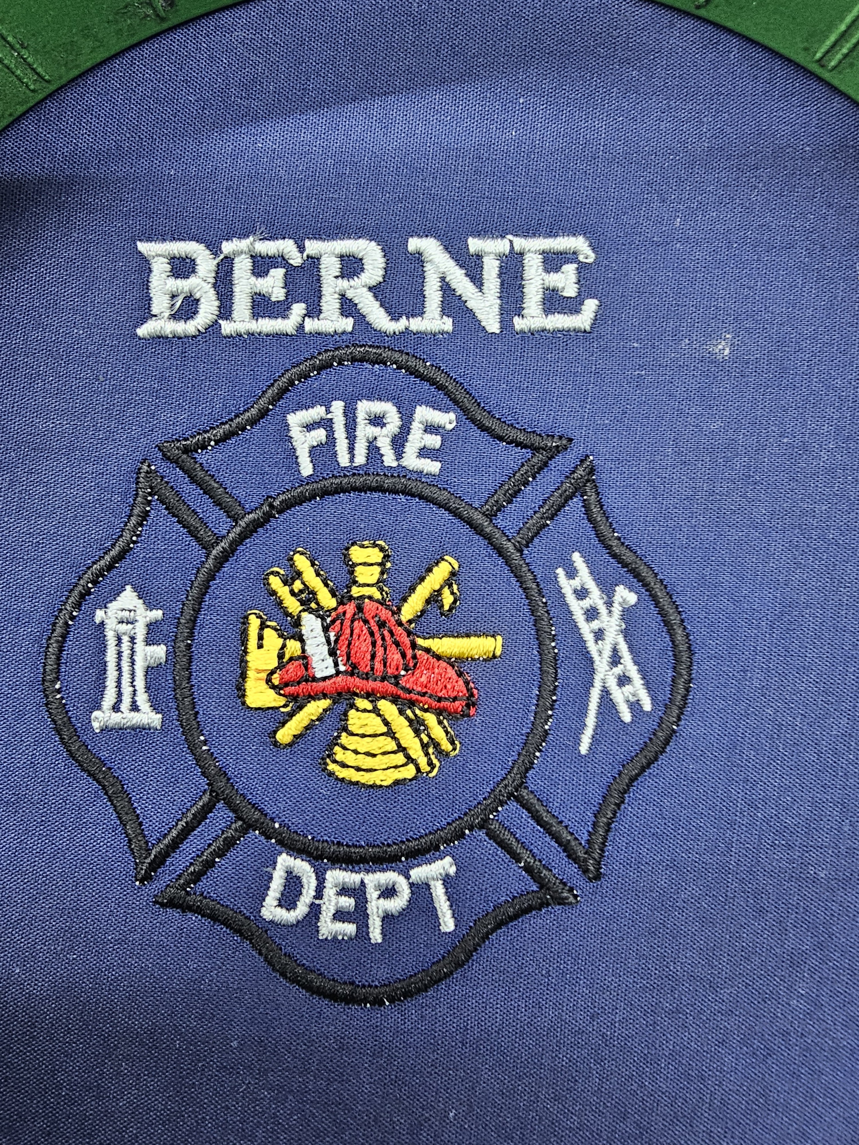

Why do I get white specs in small still stitches?
Boudica
is it pulling the backing/stabilizer through? That's what it looks like from here.
WildWestDesigns
Looks like thread tension issues to me.
What does the ratio to upper/lower thread look like on the back?
I real down and dirty fix to that one thing right there, is that there are pens to do touch up until a fix is found.
