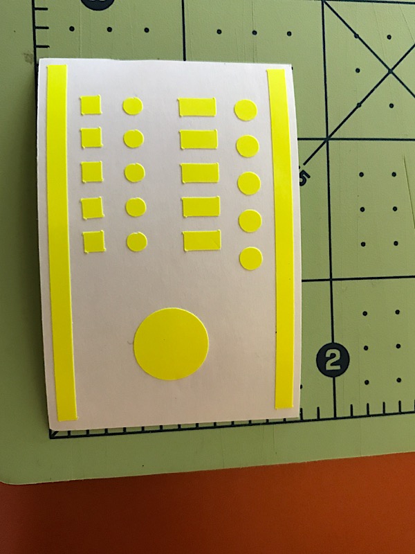

IMG_1337.jpg Ok y'all, I need something to the effect of what's in the picture. It's tiny and I need to know who can do it and what it's going to cost. Just plotted, weeded, and cut to size (no premask). I'm still waiting for color verification but originally it was red, green and orange 3m 5100 series but I have a feeling it will be fluorescent 3m. Small dots are .1" as are the long rectangle widths (for scale. Ordering in quantities of 100 sets (same color)
**** all pieces will be the same color,unlike the picture above***

We have decided on using fluorescent similar to Orafol 6510 (doesn't have to be high performance but not a temporary). this is an example of our first attempt for size reference, this would be considered one set.

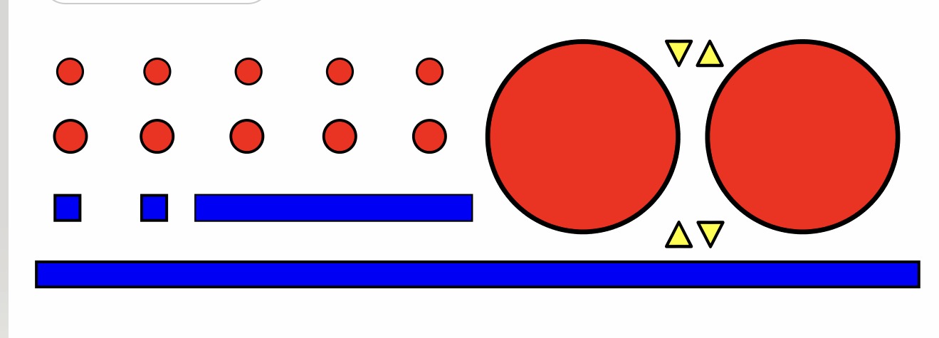

We have been experimenting with different sizes and types of vinyl... I'm open to suggestions on what type of vinyl to use that would be agressive enough! I have added an eps zip and a sample from our early prototypes...the lady in the weed room wanted to shoot me when she saw how it cut, but they can't figure out the offset issue and we never run stuff this small (It's all wraps and big fleet stuff here and I don't want to push the issue)

Run 5-10 of these. Time the plotter run time, and the weeding time. Determine what you need to make on an hourly rate and convert that through your pricing of 100.
I find trying to quote small stuff like this by the square foot usually hurts me in the end. To make it realistic, I run trials and then determine the quote.
It's a bit of a handshake agreement with the client at that point, as I usually would have their business already, based on a "soft quote."
As for offset, both your machine and software should have settings. Run tests on squares, stars, letters, and run a few different options.
Your blade could be dull or cutting strip chewed up, but I'd say it has more to do with offset.
I run small stuff like this all the time on my Graphtec at 0 offset with a 45 degree blade. And very light overcut added through Flexi.
