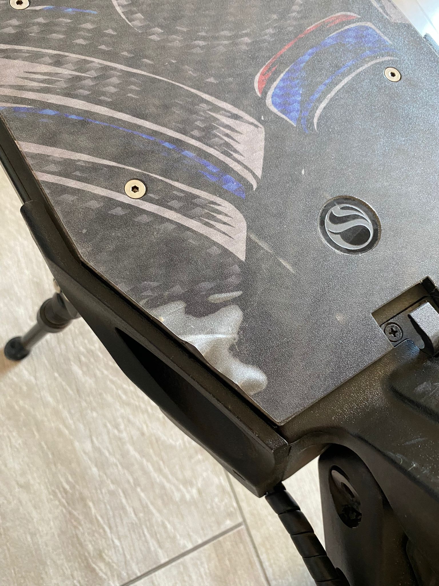

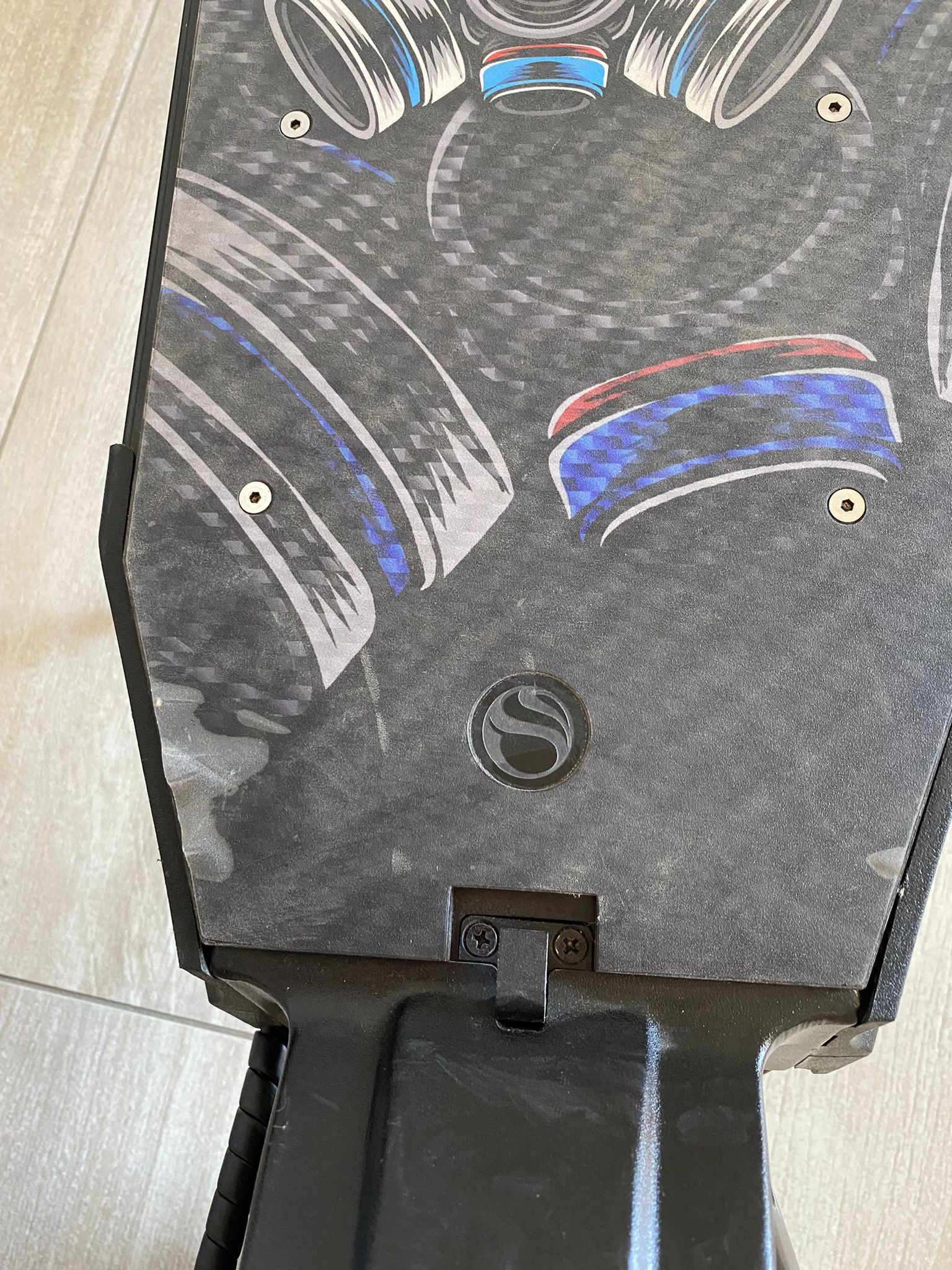

Basically, a client of my client sent him a photo to show him that the lamination shrinked over the vinyl, and peeled off. I'm attaching two pics so you can see... They are custom prints for oversized decks for electric scooters.

It says Avery DOL 6000FR is a floor graphic lamination for indoor use and maximum 9 months only. I have never used this material but making sure the vinyl and laminates are compatible for expansion and contraction are important. In my experience, its better to maker sure materials play nice with printer and laminator settings. Don't experiment on a large job without testing, testing, testing - otherwise it gets expensive. Good luck!

Looks to me like hes been kicking that/it's hit something or else. He's putting the blame on you now.
But yeah, you should definitely get something that is meant for outdoors...

What Proofread said... the DOL 6000FR is an indoor only temporary floor laminate. I'm not as familiar w/ Avery but the 3060/3070/3080 seem closer to correct for your application.

I was advised by my vinyl supplier to buy DOL 6000FR (he do not have Avery 3060/3070/3080). He praised the quality of this lamination and relied on the fact that if it resists even being trampled and washed hundreds of times inside shopping malls or whatsoever, it definitely would not give problems outside, only stepped on for a few minutes by a single person mostly standing.
Btw, the damage visible in the photo has appeared just now on a board purchased 2 months ago.

Check out the technical bulletin from Avery, not sure if you're having a temperature, tension issue or it's just the wrong material for your customer's need. Did you show your vinyl supplier the issue of delaminating?

Yes, I show him the issue and he said that, for him, it's a damage caused by customer and not a lamination problem because Avery DOL 6000 is the best lam bla bla bla and only I am having such problems... Still, laminate shrinked down up to 1mm exposing the print, like it was never properly attached to it.
Maybe this lam is not strong enough to stay on top of a high-tack vinyl? I definately am not going to buy a 30€/mq cast lamination :D

Who installed the graphic, the customer? We won't warranty any installation if we didn't perform it. Could be a combination of shrinkage from outdoor exposure to heating and contracting and improper installation, don't know.

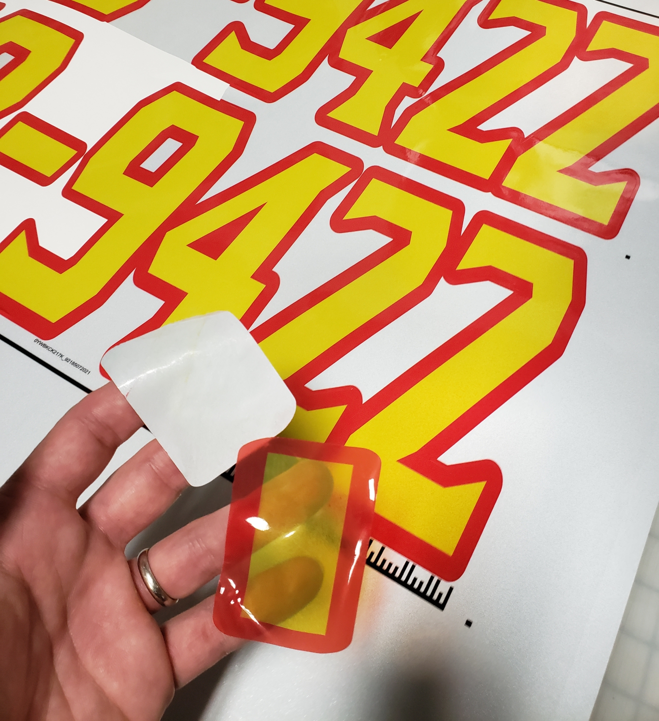

Well THIS is a first. The HP Latex ink stuck to the overlaminate when separated. (Reflective vinyl) So I imagine the plasticizers or whatever in the reflective migrated heavily to the surface during the curing process (heat) so much so that they created an almost solid layer at the top, with the ink. This is CRAZY!

Ohhh been there, been there. Make sure it's a digitally receptive reflective vinyl. We switched to 3M 51000R. Or you can leave a white inset so that lam is sticking to the naked vinyl and not ink.
