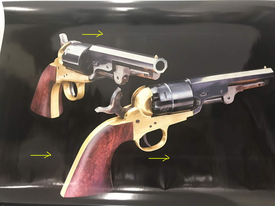

I have a Roland VS 540 configured as CMYK and it is printing random ( anywhere from a couple of inches to couple feet) washout lines across the darker colours.
Im attaching picture. Its a little hard to see in picture but vary noticeable in person. Dealer doesn't seem to know why. Tried different computer, Vinyl and File formats.

sure its not a head strike? some materials your supposed to start them off cold and let the machine heat up while its printing. found that out the hard way lol.
J.Stewart
The print in the picture is 4ft wide and no mater the length or dark colour it happens in random spots.

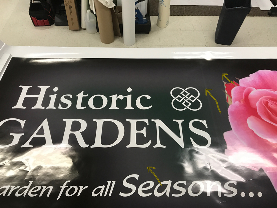

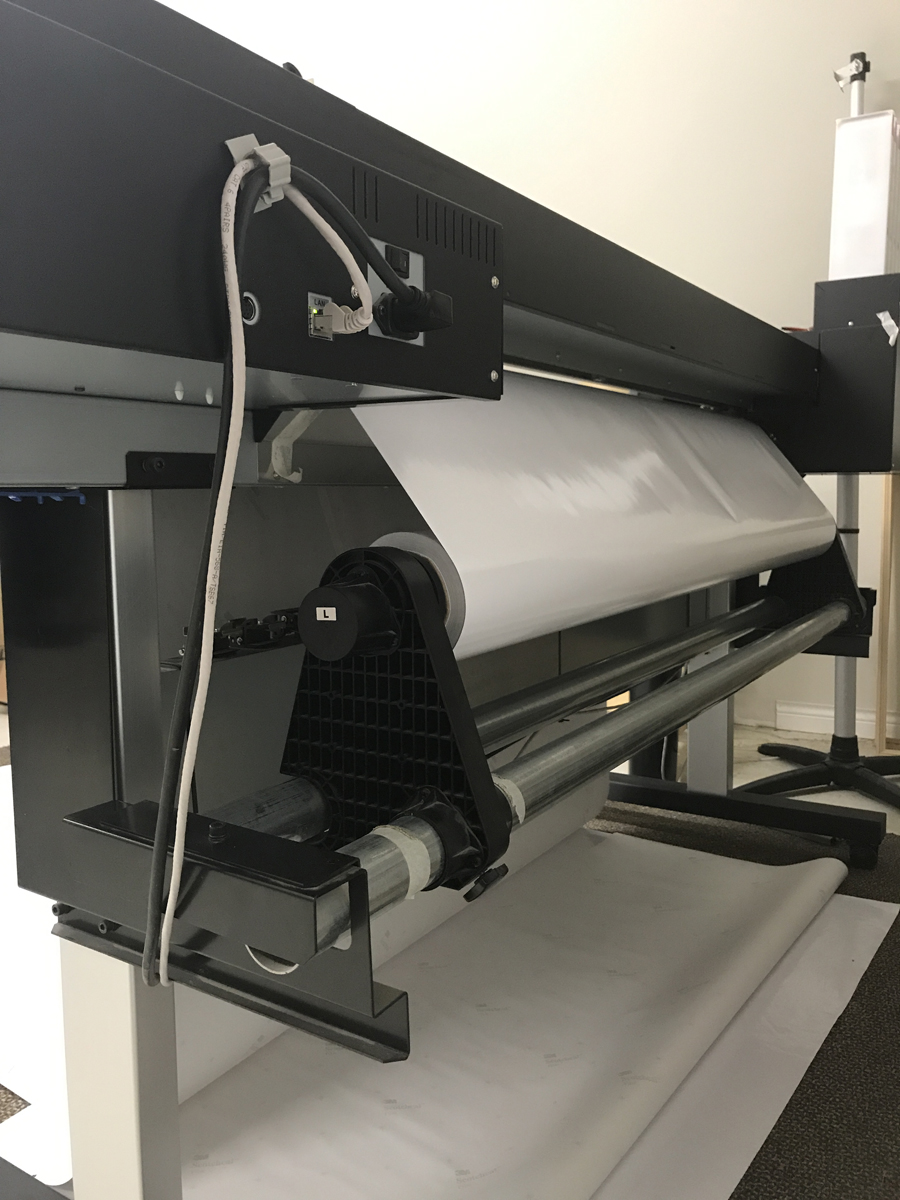

Here a couple more pictures. I store my media up right and it does not lay on the rollers though that what i would normally think.
Looks like your signal is getting a little bamboozled and drops ever so slightly, but not enough to power it off. Only shows up in dark and kinda solid colors as the gradients or lighter colors don't transmit as much information in a sense.
J.Stewart
As in the power or in the network communications? i tried 3 computes but they all went through the same network. may be i can go direct to printer.
