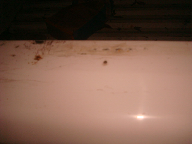

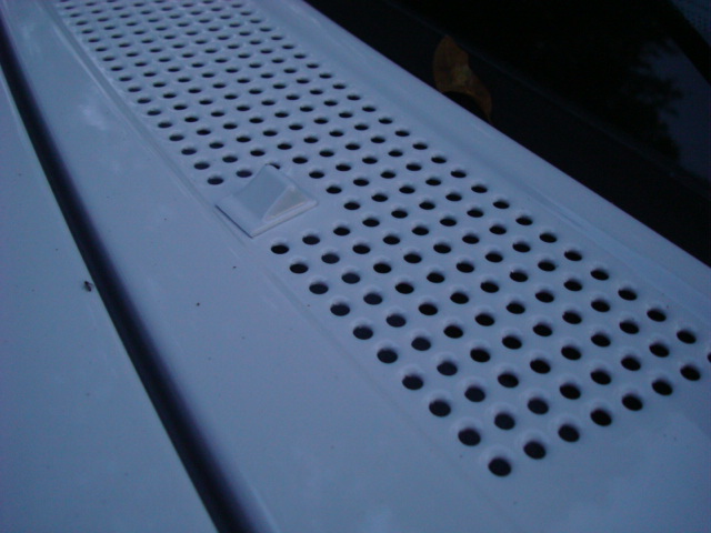

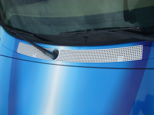

What have you guys used to tuck in the vinyl in the little holes on the hood? And not sure about going over the rust and holes on the bed?? thanks b

Designer Wraps
Don't cover the holes, just trim around them (the entire rectangle).
Just go over the rust. It doesn't look too bad - just hit it with a little sandpaper to clean it up a bit (inform customer first). No warranties either!
WOODBS
yeah, my thoughts exactly on the rust..the holes though?? blue print with a white rectangle ..nahh,
ProWraps
those holes are a nightmare. we cut "x" s in them and pushed them in with a phillips head screwdriver (one that fit perfectly in the hole). terrible way to do it and will probably fail. but wth are you supposed to do with those things? our wrap was black on a white ranger. there was no way we were going to cut out the entire rectangle.
Malkin
Maybe use perf window film in that rectangular area? Course it would have to be with no lam (to let air through), and that stuff is not rated for long anyway...
:doh:

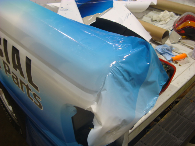

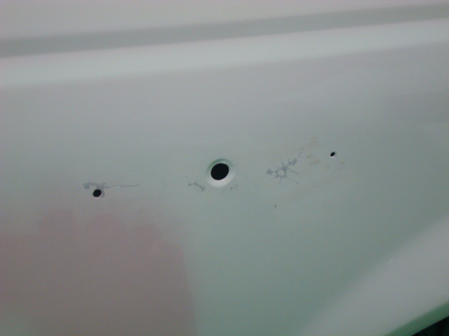

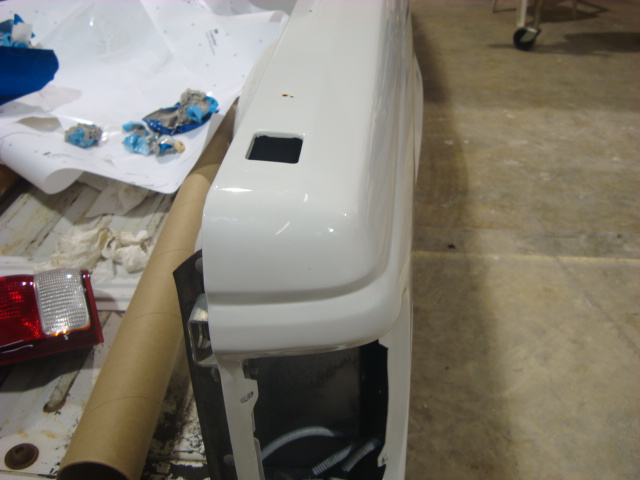

one issue i have now is the rear bed corner. what are you guys doing there? any relief cuts..or just heat and work? also any ideas for covering a forgotton emblem hole..i am thinking of wrapping a plastic push-pin..and insert in the opening..thanks for any help

kstompaint
What material are you using? You shouldn't have any trouble with that bed corner, just take your time and keep applying heat. Also, make sure you post heat the hell outta it, especially in the body line "v".
As for the cowl vent holes... it sucks, but we cut 'em each out.

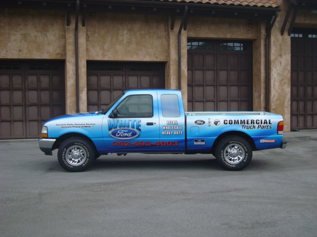

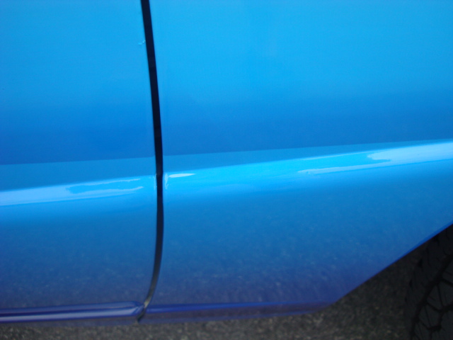

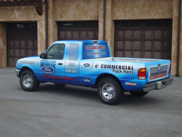

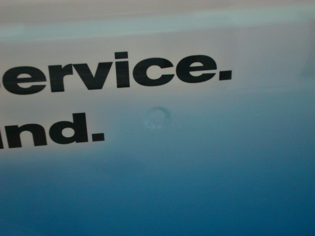

thanks for the advice..all went well after all. I took the bumper off to get all vinyl behind , what do you think? and took the advice of cutting the holes out..looks fine
