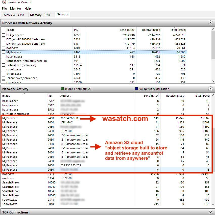

Hi, your comment made me look into the matter again. It turns out Rasterlink is communicating with Wasatch and Amazon when importing and ripping jobs. The Wasatch rip engine is used by Rasterlink (mijpeer.exe). So either Wasatch (and Mimaki?) are collecting data based on import and rip activity. I guess there were issues with these remote servers a few days ago, which caused Rasterlink to crawl.
