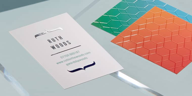

We just purchased a Mimaki JV300-160 roll printer. My question is what is the naming convention in Illustrator for spot white and spot varnish so that rasterlink will recognize and print it correctly. Also, after we have figured that out, is there anything else we have to do in rasterlink to make this print correctly? Here is an example of what we are looking to do...
Thank you!!
