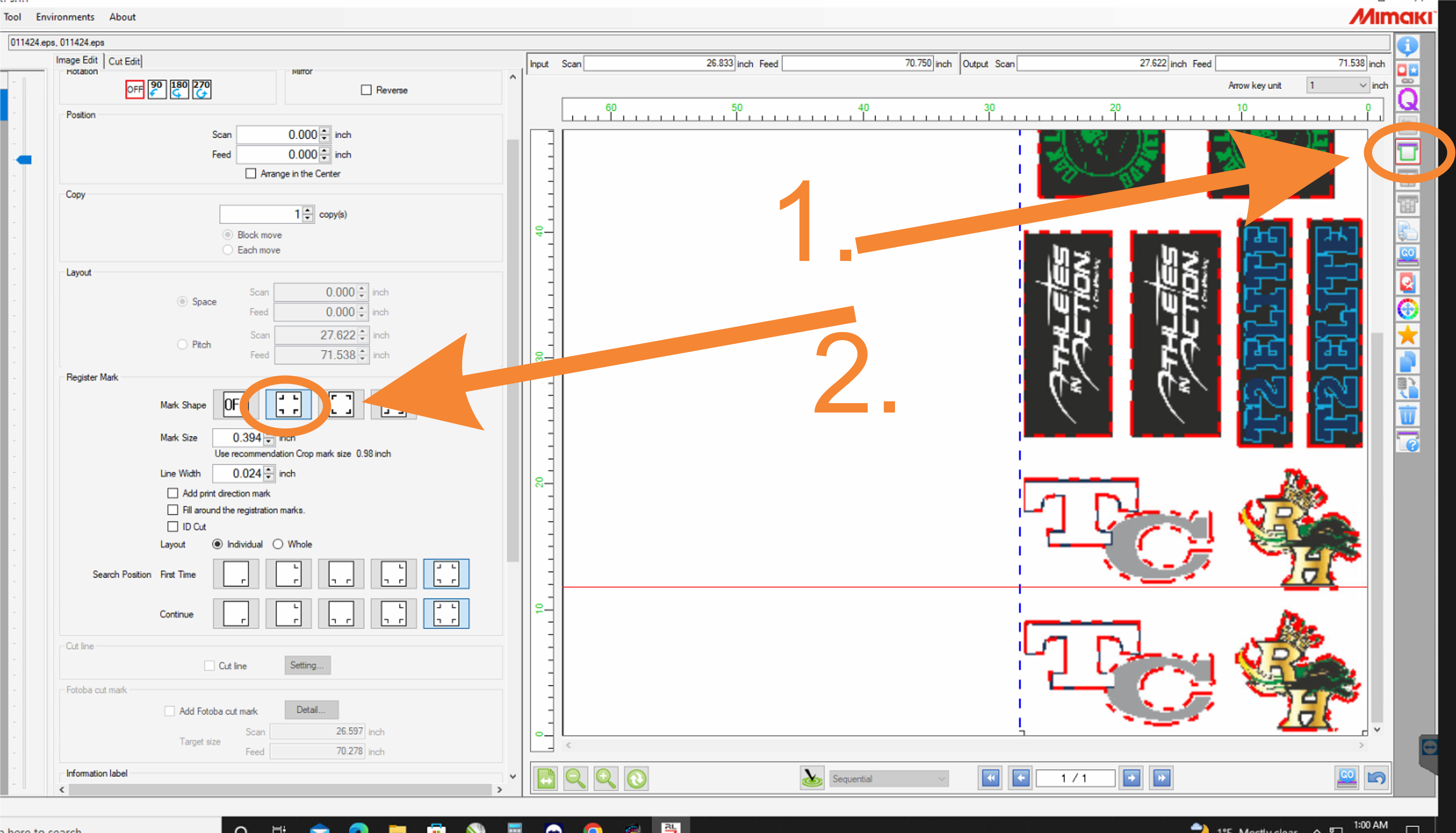

-Where and how do I turn on crop marks?
I guess the marks are technically called register marks. In Rasterlink, after you have set the resolution and passes, etc. Click the 5th box down on the right, then on the left pick the type of mark to use.
