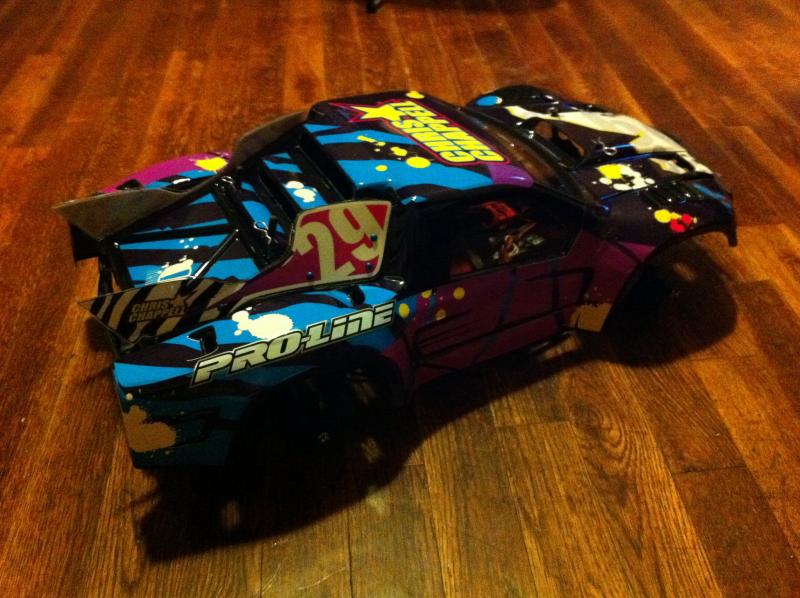

Done a couple of these for people, did this one for my truck the other day. Went for a wild, 80's, punk inspired look. Need to adjust some aspects to get some of the design to line up a little better between some panels in some places but overall I like it, was fun anyway.
IJ180C with 8518, printed on Roland vs540.
Sorry, not the best pics in the world though.

k.a.s.
Did you do this in one piece or use templates? Also was it hard to hold the body (since they are pretty flimsey) while you installed?

Templates, I use Oracal paint mask (the brown semi-transparent type, I am going blank on the product number) and draw out the separate panels with a marker and scan them and recreate the lines. Do a couple of test panels, make adjustments, then do the layout print and stick. Determining on the body it can take a bit to get the panels correct but it isn't too bad.
When I can I stick the graphics before trimming the body out, it helps with the flimsy.
