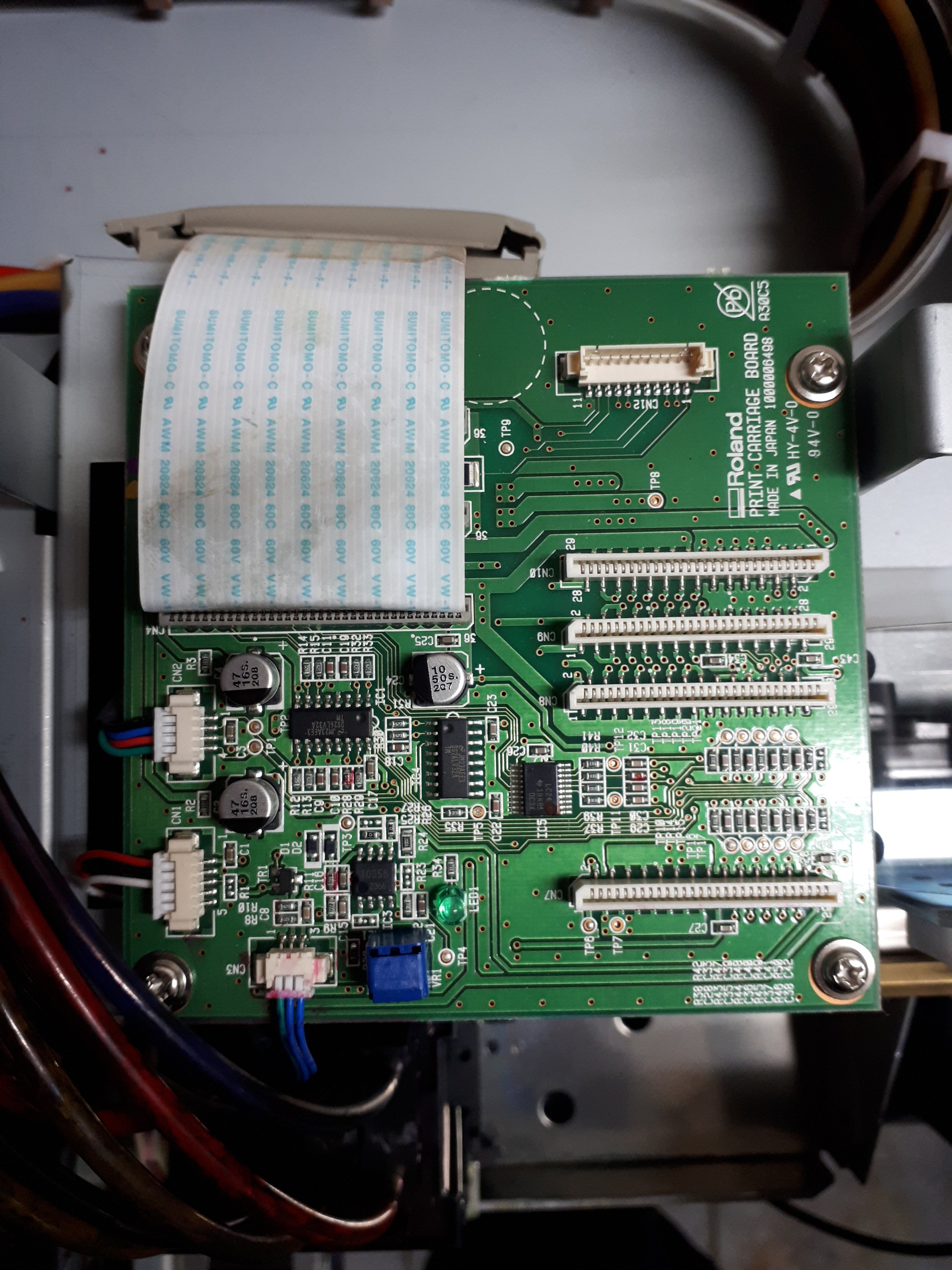

I have not solve my problem on my Re-640, here are the symptoms of the machine,
Changed Dampers and a bit of ink landed on the Print Carriage Board but all fuses have connectivity and all boards light up except Servor Board therefore I disconnect the flex cables from the Print Carriage Board to the printhead to test and Servor Board light.
Solutions:
I changed Print Carriage Board and Linear Encoder Sensor and did Linear Encoder and Linear Encoder check and passed
Final Test:
Its printing Blank so it tells me its electrical problem, I took print head out to check if there is ink on it but it clean and nice then I reset all flex cables from print head to Print Carriage Board still printing blank. Could it be the 3 Ribbon Cables (main board to carriage board p/n# 1000004962) but I check end to end connectivity (every pin) and its good but I could miss some
Do I go ahead and order the 3 Ribbon Cables (main board to carriage board) or missing some steps, appreciate your help as always

It doesn't seem to be a ribbon cable problem at all. If there was a short circuit than it might be a printhead issue.

PH is dead for 95% then.
Thank V.V I kinda of in denial about it but the back of my mind it's a short at the print head board during dampers changed. Do you know anyone can repair a short on the print head or get a refurbish one? Thanks for your reply
Ultraman
Ultraman
It's impossible unfortunately, only replacement is an option.

I don't have the chance to see if the print head works or not and double checked that I indeed install back the print head correctly (F facing me). I checked the fuses and it blew again so I took it to check with an electrician and found that a pair of transistors reading low or OL. My question is, can I still upload the main board parameters just be to safe and do you have an RE-640 default parameters send to me? I want to see this job go...Man. Thank-you

It's not surprising me that transistors are "burned" or in short. Means PH is dead 150%.
Why do you need to upload MB parameters? It's not necessary if you replace PH or parts on MB.
Moreover, you can use Firmware pack to upload all the defaults.

Finally RE-640 Print head arrived, installed it with new data head flex cables, keyed in rank# powerful clean x 2 clear old rank# and medium clean, test print but one whole magenta panel not printing at all (double cmyk) so I re-set the data head flex cables and there is a plastic flap that protects the flex cables which I forgot the flap back and lock resulting a head crashed (flex cable bend slightly) and all power was shut off so I put back the old data head flex cables to try but now its not printing anything again even though it power up with no problem. I check all fuses and even transistors reading was good...does it mean the print head short again?
If I need to replace MB, what I need to do or how to re-set MB?
Sigh...this job still not going. Thanks Brother
