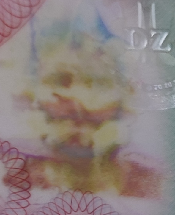

I Have mimaki cjv150
I have situation in my printer that print in ID card lik ghost. Any help please this is photo prinr
