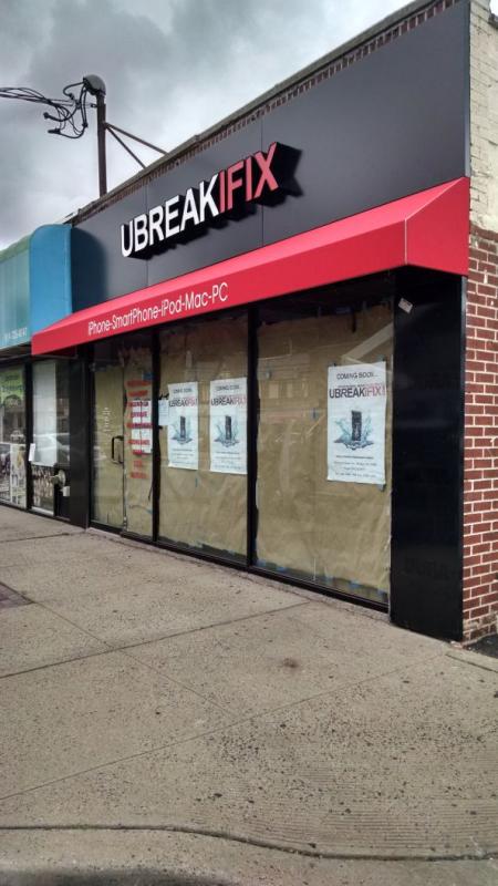

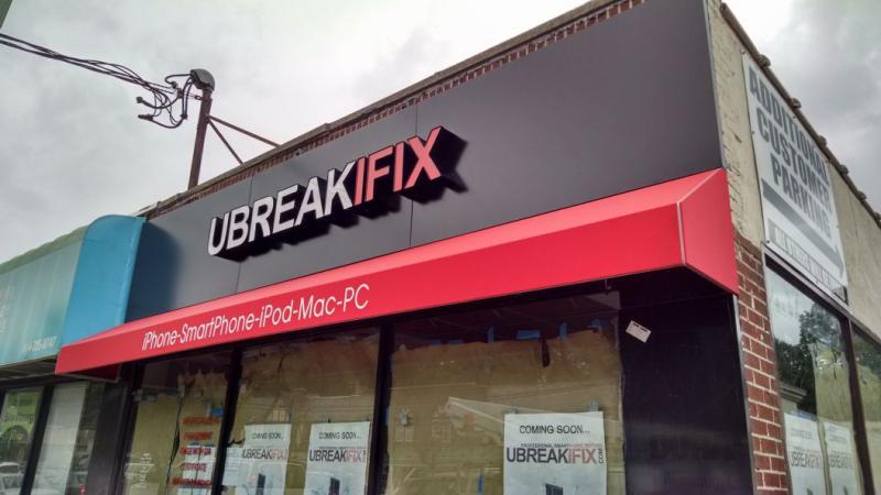

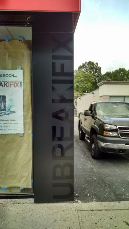

Installed last week. We did the entire storefront including the ACM staging panel and awning. Only regret is that we were not able to push the entire thing over the last row of bricks because of structural issues on the building.

Very nice. I see what you mean about the bricks, but still a job to be proud of.
How did you attach the panels together? I don't see any fasteners.
Signsforwhile
The panels are 2" deep and have an aluminum tube frame inside. We mounted aluminum angle along the top where the panels go, placed the frame to sit on the angle then drove screws through the tops of the panels down into the angle aluminum. Then once the awning was installed we drove screws up from the inside of the awning into the bottom of the black panels.
