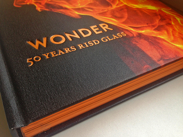

I'm looking for advice on which wide format printer would be best for printing book covers.
We print high-end photo books for the consumer and professional photography markets, so quality is important. But more important is durability and longevity.
I had an HP 365 for a while and I liked many aspects of it, but unfortunately the ink rubs off. I put some test books on my shelf along side another book with a white cover, and after a few weeks, the white cover was stained with the ink from the latex print. I've tried some tests on the new 700 version, and while better, it still suffers the same issue, even with the overcoating turned up to max.
I haven't tried any other textile print technologies yet, so can you advise what else is out there that won't suffer this rubbing issue. Because these books will sit on shelves, often exposed to direct light, fade resistance is also a consideration.
Thanks in advance for any insights
Geoff

we're planning to use a cloth that resembles a woven linen, even though it is actually fabric. The most populat is called Iris.

You could try something like canvastex - not going to get you that lovely debossed text, but not far off in appearance. UV protection, no ink migration and reasonably scuff resistant. I don't know whether it, or similar will work with other than aqueous inks.
