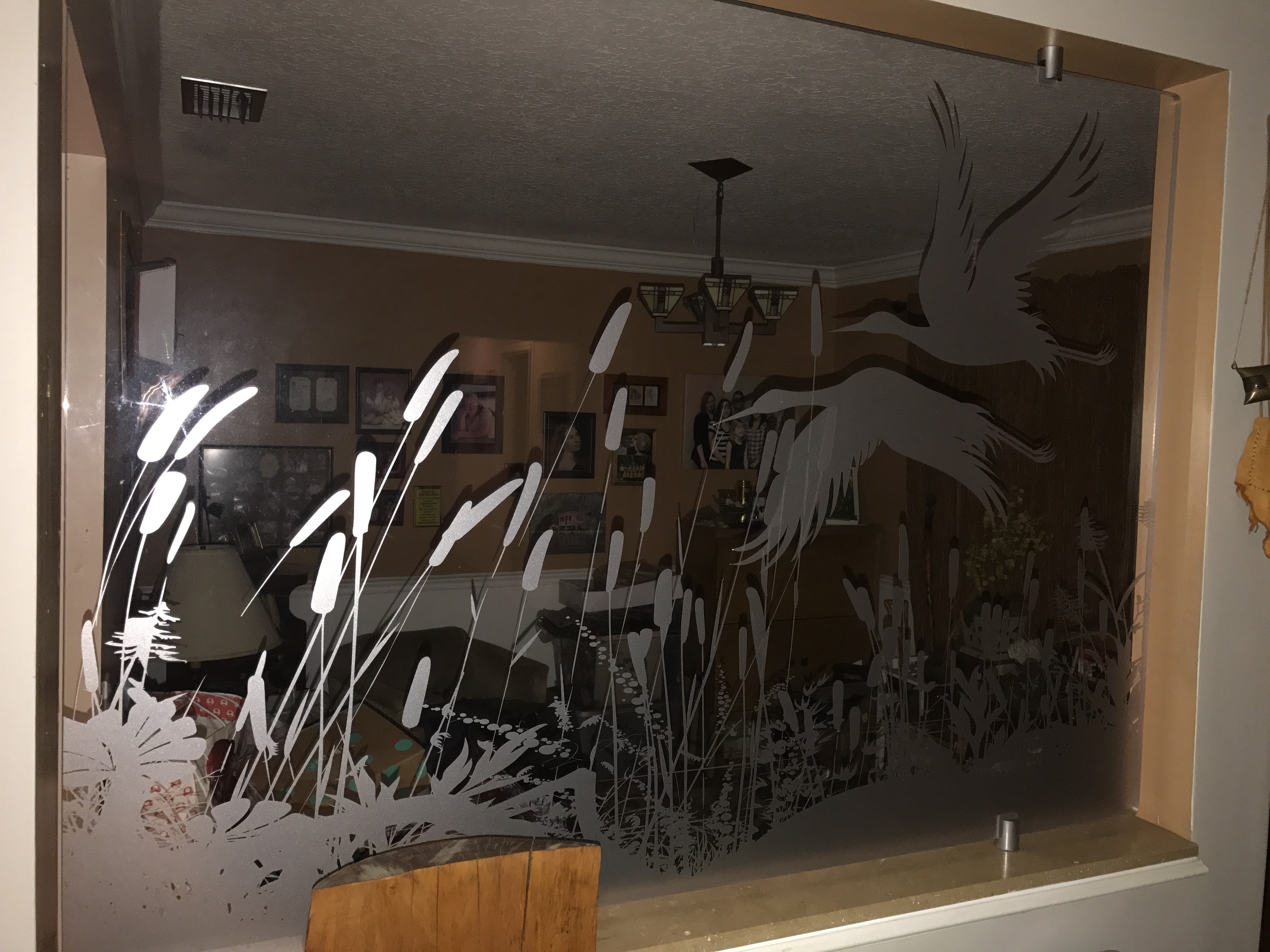

It's a pain. Best bet is length of time begore removing premask and spraying more rt2 on mask prior to trying to remove it. Pic is 3/4 ex in my living room. It was done wet so initially it had bubbles but they went away fairly quick.
