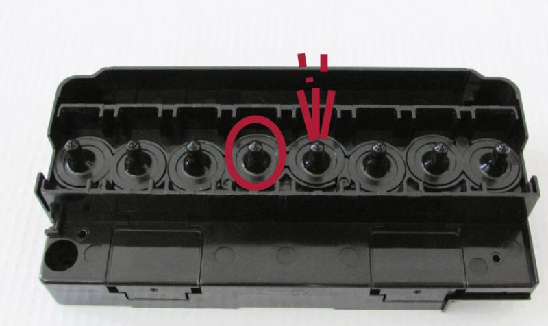

got a solid deal on a jv33 that had been sitting. I have been soaking the head for the past week adding solution every other day. Using a syringe this morning I used a little pressure through ech chamber on the manifold lines with pretty great success! while doing all of the manifold inlets I got clean sprays except for black... when I did black I got some spraying back up through the other black when I put pressure. I assume that means the manifold broke, I am praying that it doesn't mean the head is the issue. any feedback would be appreciated as always :)
TheSFG
to clarify where I put pressure is on the top portion where the dampers meet the manifold and sprays back from its opposite. since the machine is ran in "CMYKKYMC" I hope it's just a crack in the manifold. any experience with this?

It's probably a complete blockage of one of the black channels (inside the head itself). When you apply pressure to the channel it's probably leaking out of the rubber seal between the manifold and head and some is going back up the other black channel. Be careful as you could be damaging the pcb on the head with solvent.
I would remove the manifold - remove 3 screws on the bottom of the head and carefully remove it. Check damage on the manifold itself (block the exit tube with finger and force liquid through). If that's good, clean and resit the rubber seal, then reattach the manifold making sure the holes all line up (make sure you don't have liquid on the pcb). Try some liquid again and see if it has fixed the issue. If not, you have a complete blockage and the only thing you could do is put the head in a ultrasonic cleaner and see if that unblocks it.
Just speaking from my own experience, others may have a different idea, but that's how I would approach it. Just remember, any of this can possibly damage your head further, so proceed only if you're prepared for the worst outcome! That being said, I have repaired several DX5 heads this way.

The rubber gasket between the head and manifold is generally pretty darn tight and its very unlikely that pushing fluid into one channel would cause it to come back out of the next channel via that rubber gasket. If anything, a leak there would just have cleaning fluid leaking onto the top of the heads circuit board and running out the edges under the manifold. 95% odds with what it is doing is the internal structure inside the head between those 2 channels has ruptured and the head is for all intents and purposes internally damaged and ruined.
Also be very careful on mixing different chemicals or using other chemicals to clean or flush. I have seen firsthand two different brands of cleaning solvent as well as ISO alcohol that when mixed basically turns into a thick gel like substance. Not saying it will happen but saying I'd test it in a small dish or something first. Mix a bit of the two up good and let it sit for several minutes. If they happen to be incompatible and turn into a thick goop inside a head..... that head is done. Alcohol is also not a great solvent for this as it evaporates too quick to be useful for any sort of soaking - only really good for immediate wiping/cleaning.

You broke the inside of the head and there is absolutely no doubt about it. On a DX5 head there are 8 separate channels. They never come in contact with each other at any point in the structure of the head. When you push solution through one channel and it comes out the other, it's cooked.
Edit: Also never use alcohol on these heads other then to clean non-important surfaces. When mixed with the solvent ink in the head, it will coagulate.
