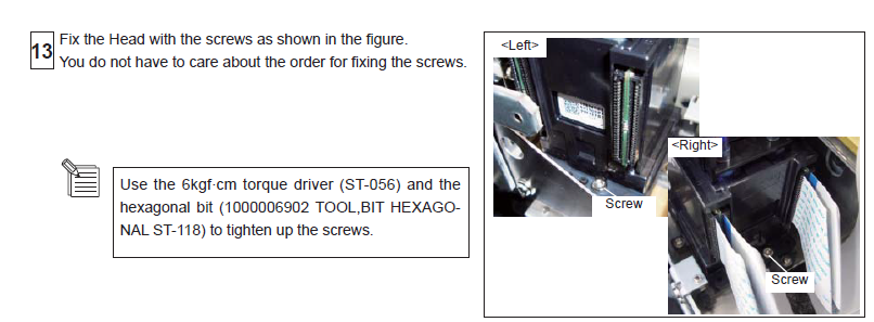

I also noticed for installing the head, they specify a torque driver model that has a 3% accuracy and the torque amount on the head screws.
I was wondering how crucial is the accuracy? I was looking at buying a FIRSTINFO precision torque screwdriver with a 6% accuracy (https://www.amazon.ca/gp/product/B00XV8GVQK/ref=ox_sc_act_title_1?smid=ALG9VSBC5I2EQ&th=1)
6kgt-cm equals to 0.588399 newton meter. So setting it at 6 NM would probably do the trick?

With all the many heads I have replaced in the past, I have never torqued the screws to hold them. As long as they are normally tight then they are fine

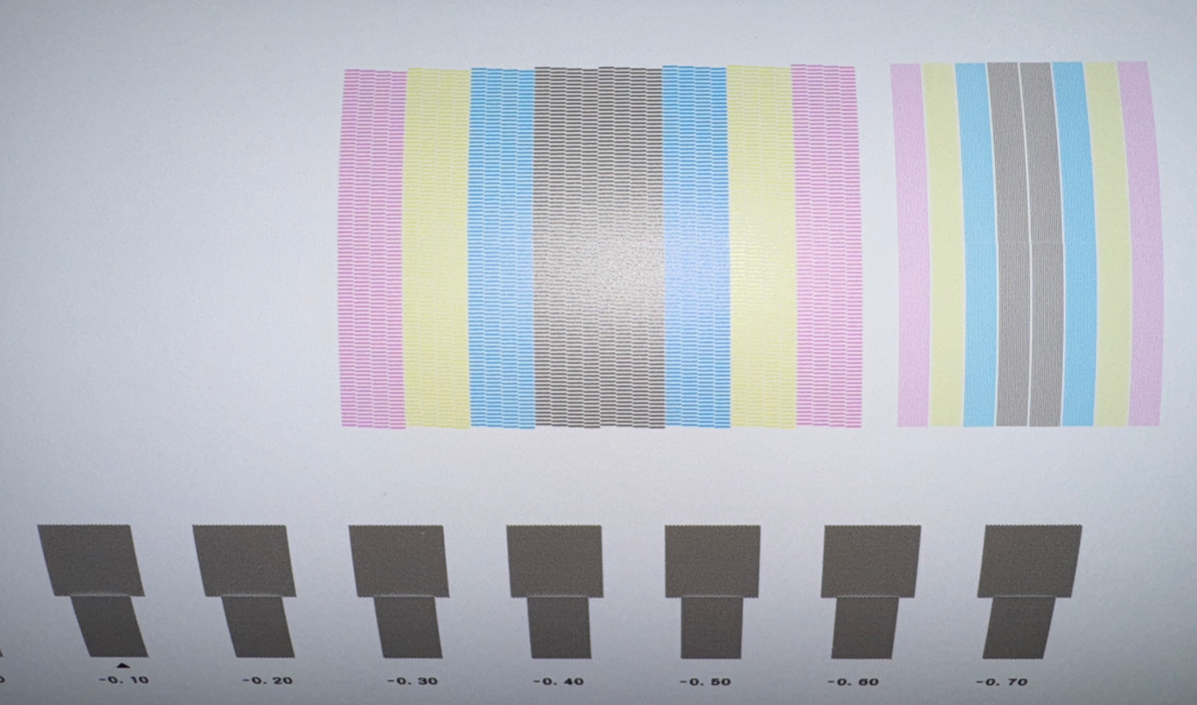

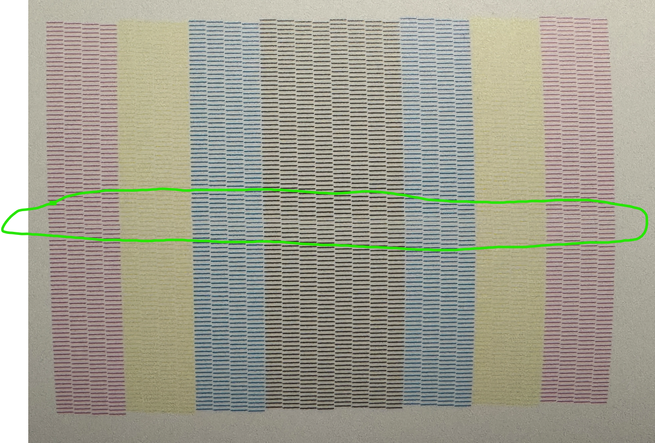

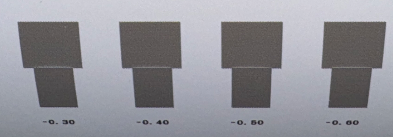

One thing that I noticed, is the "faded" area when doing the head calibration normal (see below)? Sorry for the bad picture but as you can see there is a small faded area between the head passes.
Same as within the nozzle print test, if you look closely its it a bit dimmer when the 2nd head pass starts.
Sometimes it shows perfectly normal, wasn't sure if that is a problem or is something like the pump could cause this.
The prints are looking great and nothing else seems abnormal.

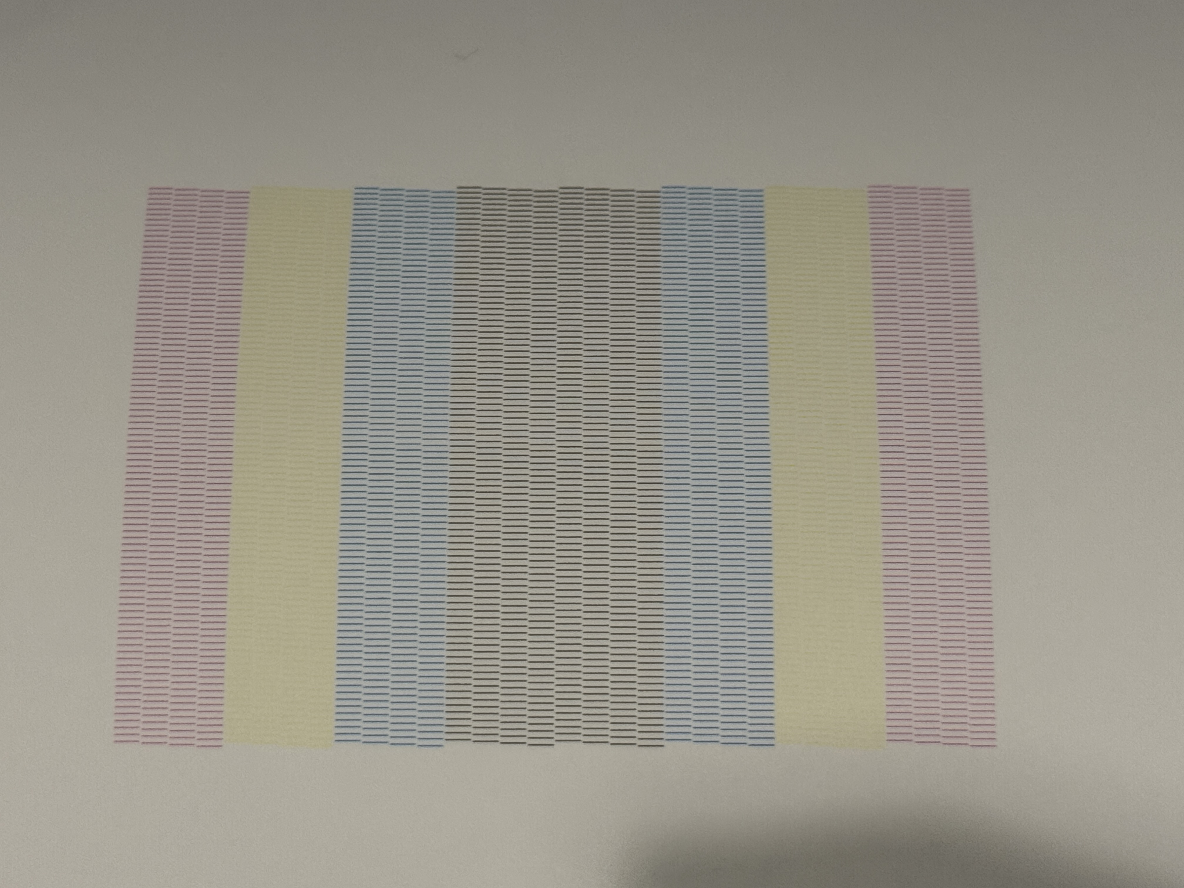

Regarding my nozzle test and the head calibration feed tests.
I noticed when watching videos the blocks its printing are usually solid:
Is there anything specific that can cause mine to be faded on the lower edge of the 2nd print pass? Here is what I mean from my print tests. Somehow when the ink should meet its faded. However its not faded on each sides.
It also seems to show on all colors when doing my nozzle print test, there is a slight fade between the 2 head passes. Wanted to make sure this isnt showing a sign of failure of something like a pump etc.
*When fiddling around the old head to see if I could find a workaround to finish my print job, I also ran all of those tests and I had the same fade along the edge. So I don't think its head related.

About the small fade along the edge of the print tests, have you ever seen anything like it? It was the same with the old head as well. It seems quite minor and prints are coming out ok, just wanted to make sure its not a sign of something that might be failing soon. Cap top, wipers, dampers, head are all new.

Thanks again for everyone's help, it was super helpful. Im not 100% sure what is the small fade on the 2nd head pass on the edge. Maybe the media or something, doesnt happen all the time and prints are fine regardless. At least no nozzles are missing now lol
