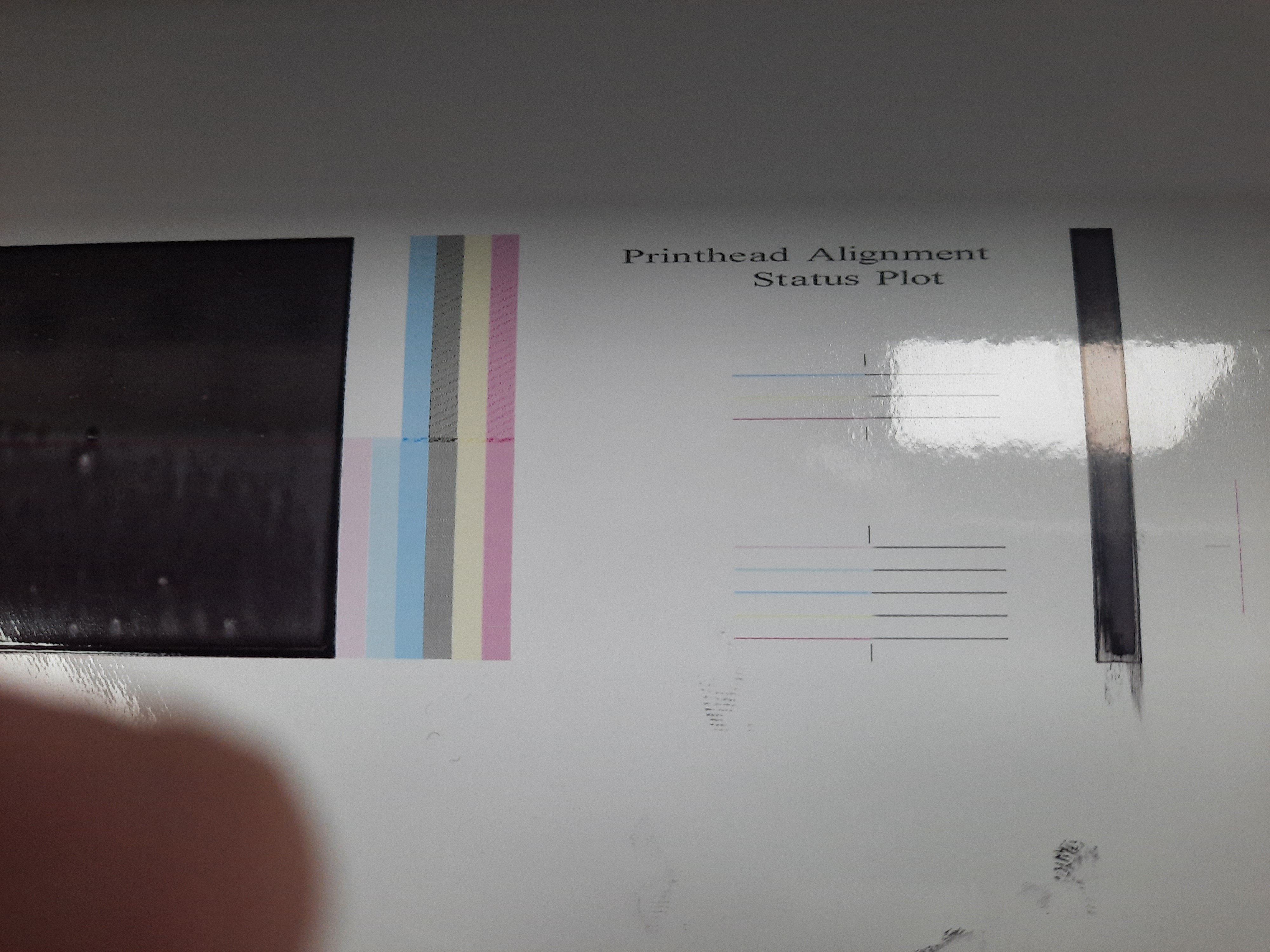

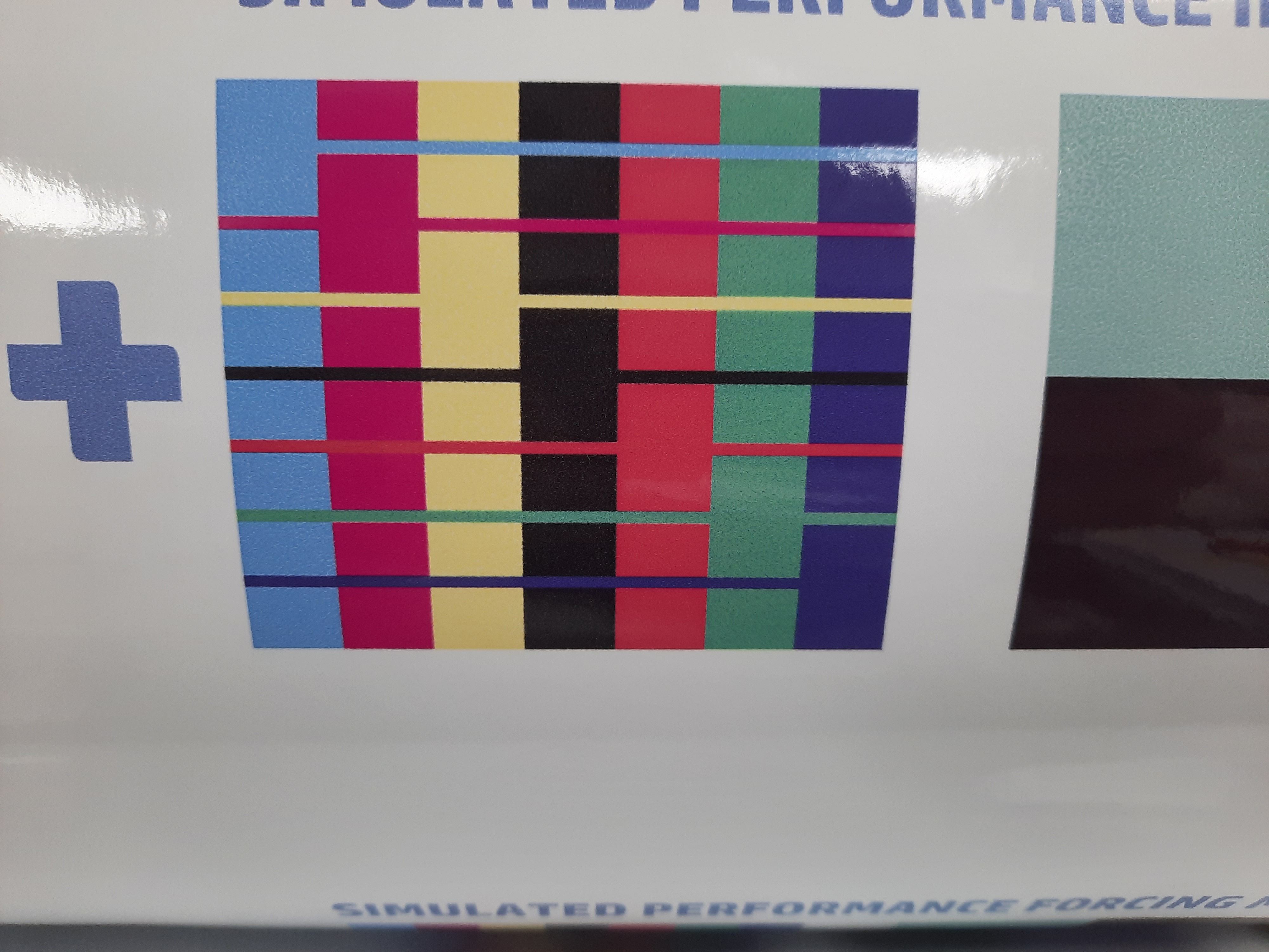

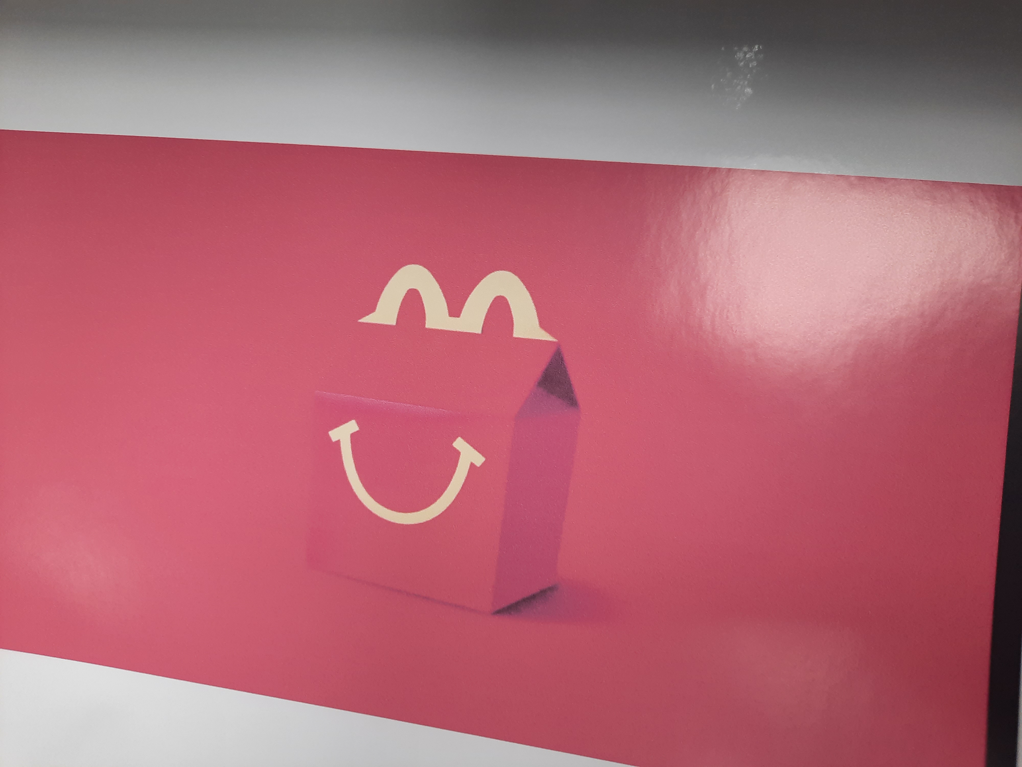

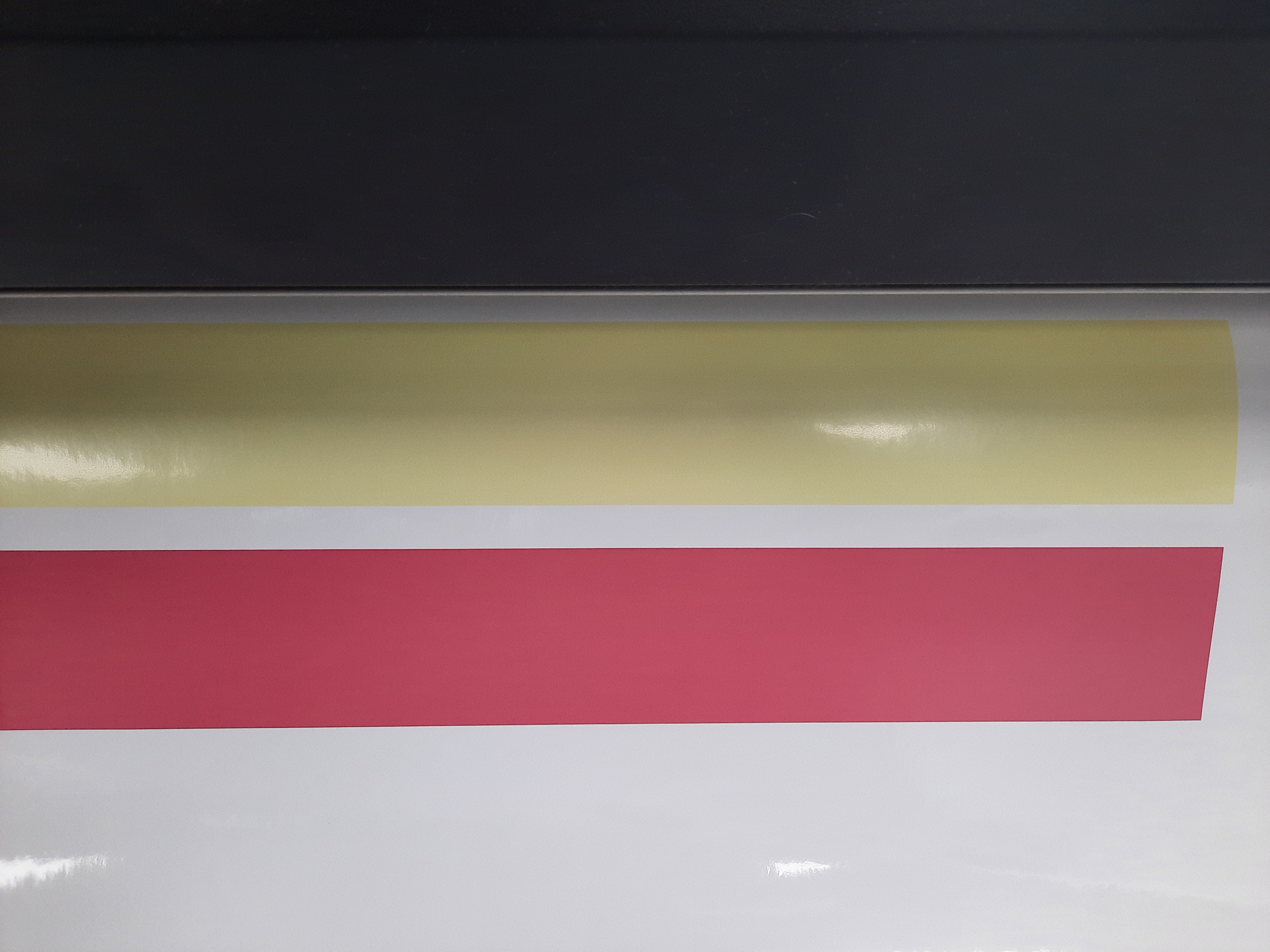

Haven't used my printer in a couple of months, Printing fine but reds are now closer to magenta and yellows muted.
Printer says all inks and OP have expired? Would this be the cause or no?
Flexi 21 - recent update
Have not changed any profiles.
Thoughts? Comments Appreciated?
Have tried various files with red that I know/knew were good!

If the ink is significantly expired (more than a few months), it is possible for the pigments to drop out of solution. This results in pigment-depleted ink which lacks the proper amount of colorant. From the pics, it is possible that the yellow ink (and possibly other inks) has fallen out of solution.
After you replace the ink carts, remember that there are about 50ml of ink in the IDS and printhead reservoir (per channel) that remains depleted. This ink can be either printed through or syringed out to allow fresh ink to get to the nozzles.

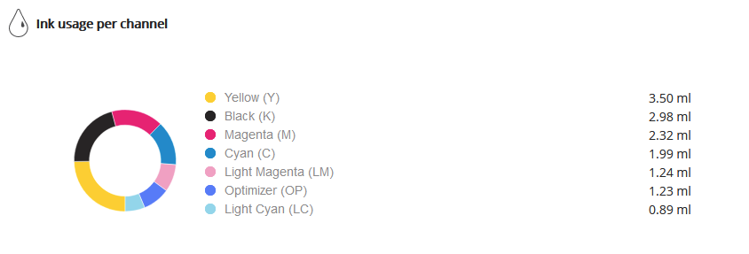

About 30ml per channel in the tubes. If you have PrintOS you can see the usage. Or just look at the total from the web server and guess approx. Or if the shade starts to change, yes.

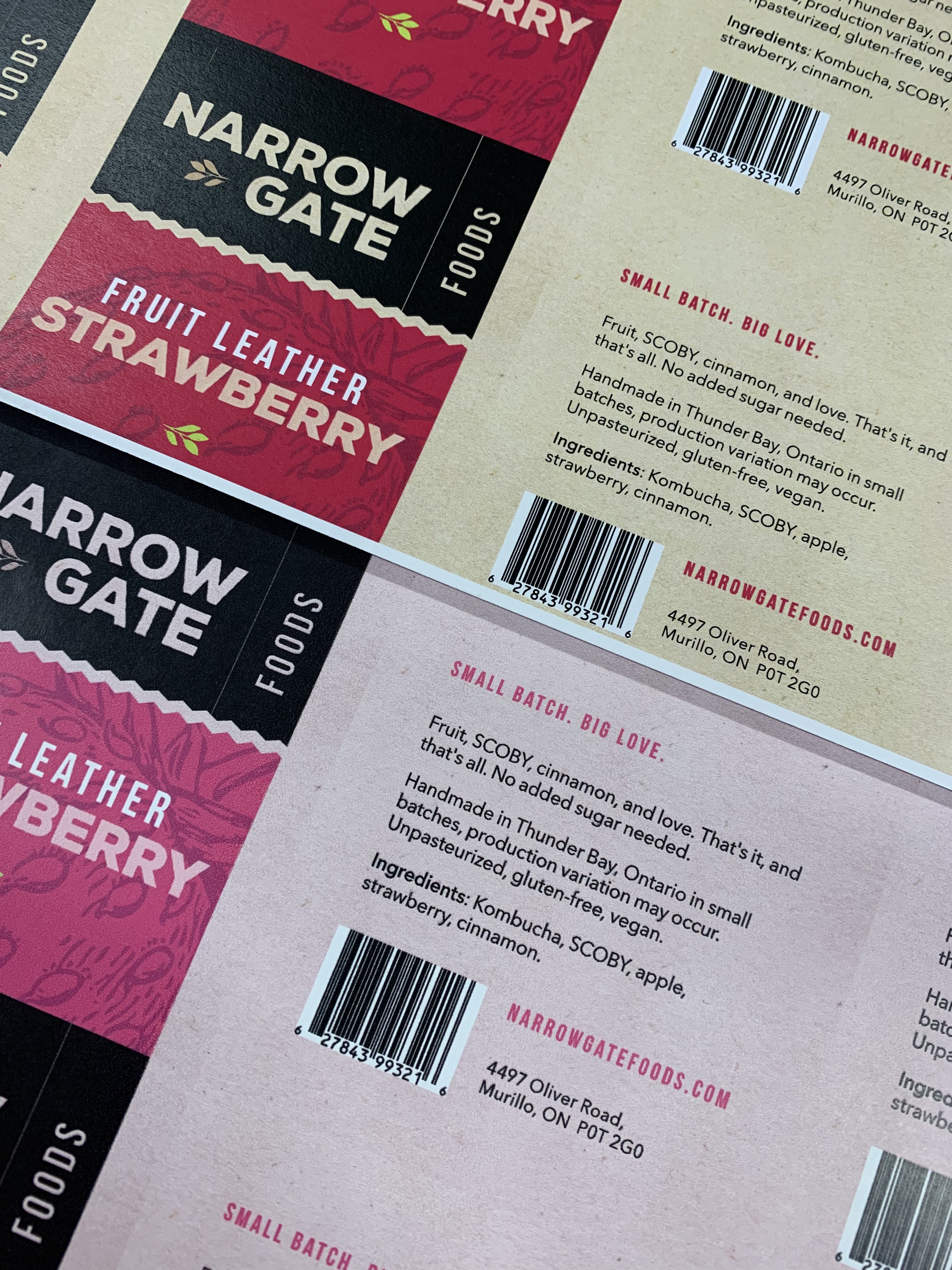

Great advice here. Today's project is finding out why our LTX 110 is printing weak yellows and this will help me to diagnose the issue. Photo attached, the top label is printed off our xerox and the bottom off the hp.

Is it low usage machine or you just had this issue suddenly?

Coming out of all the covid bs we aren't using the printer as much as we would have before. In the past month we've had a decent amount of work through the door. This all first started when I was trying to print a client's job early last week (a logo) with neutral grey made up of a combination of cmyk in the native file and then of course adjusted further at the rip per normal. It was printing pink/purple. Didn't notice much in other jobs we ran other than the label work with the beige background. I'm currently printing a yellow bar in attempt to flush the line, on the second print now. I may have to order Y/M heads as they are both expired but were running fine. I have an extra yellow ink cartridge which I can insert as well if needed as the one installed is now down to 15%.

Well you might even get away with it. It's bad when people have these and the cartridges sit for a long time. Yes - it's meant to be so that you don't need to shake it but it's also supposed to be replaced every so often, like couple of months.

How do I get HP Print OS to refresh or update so that I can see how much ink my yellow test used? I printed twice but do not see it updated in my list?

Well after installing a new yellow ink cartridge and flushing at at least 35 ml yellow ink I still have weak yellows. All head appear to be printing fine other than they are all Out of Warranty. Thoughts?
