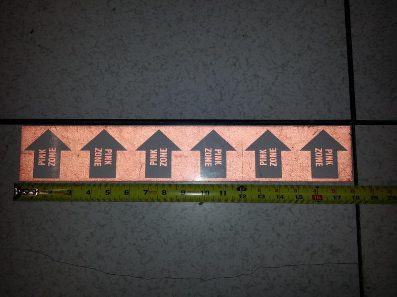

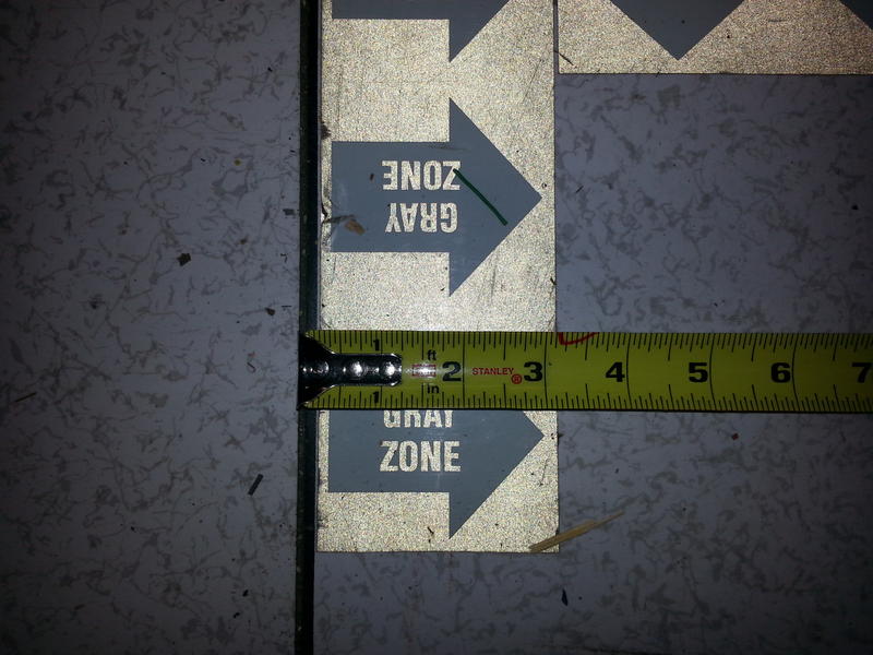

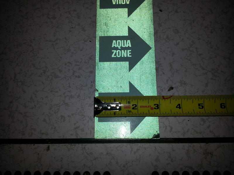

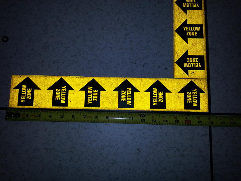

Hey All - Looking for a vendor or type of reflective to replicate these photos attached. There are different colors - pink, gray, red, aqua, etc. Any help would be appreciated.
Thanks

Just looks like print over White reflective to me. All the Green Reflective I have samples of are to dark, never seen a Pink.

Generally, when you print to white reflective, like mentioned, it will have a washed out look, as in your pictures. However, the black looks very opaque. Not sure if they printed the colors they wanted and then screen printed the black, or just did a second pass over it. The texture, is most likely, just the reflective showing through.

nope, just a straight up print by someone who knows what their doing

I would bet that they were possibly screen printed before, and some of the colors may no longer be available.
I would suggest using a Gerber Edge to print these; most of the colors are available as transparent colors and the ones that aren't could be reproduced with screening the solid color or laying down a solvent print first and then printing over them with an Edge.
