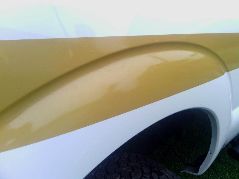

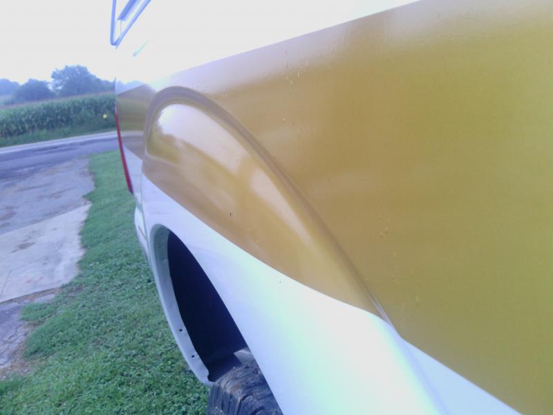

Any suggestions on the type of reflective i should be using for this application?

Looks like a ~5" stripe, and longer than the bed for measurements. ;) Application is like a wrap; with bridging and stretching. Attachment striping was done with 3M 280.

I just used the stripe the same as the rest of the truck (5.5") but pretended the recess wasn't there, then came back after I removed the the mask and heated and pushed the vinyl into the recess. Ill try to get you a video lol...I have 3 more fenders to do....
Should those small bubbles be a concern on reflective...i know that on regular vinyl they will go away...not sure on reflective....this customer is very picky....
The vinyl i used on this is Avery 1200.

use 2 hands and more pressure when installing reflective next time. i see quite a few bubbles on that install.
