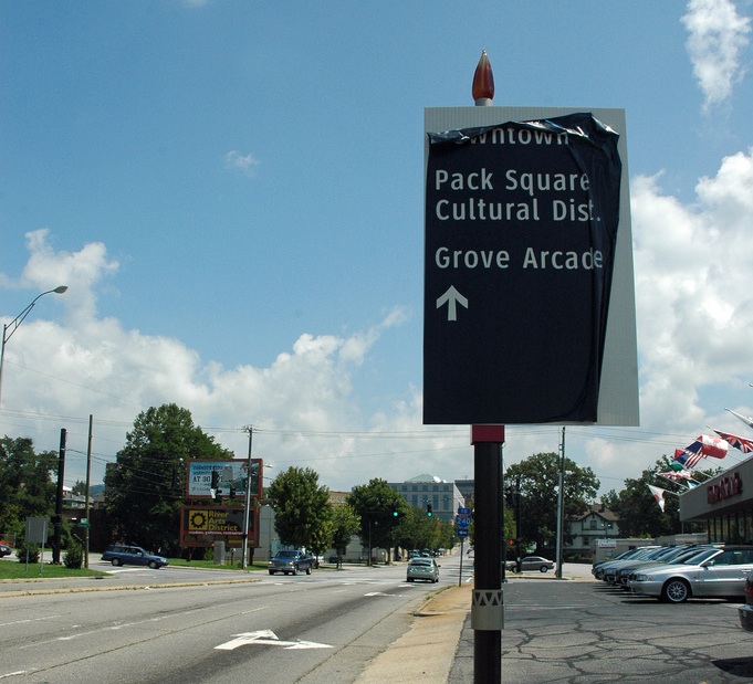

Also... be careful with digitally printing on clear as proven by the now infamous Ashville, NC Wayfinding signs...
