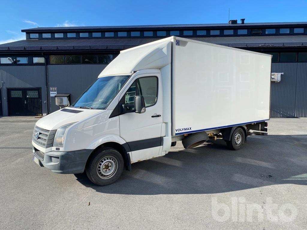

Hello guys
I´m looking for a solution to have "stickers" that you can add and remove on cargo vans (Quick and easy-like magnets) without any magnets because the sides are made out of composite/aluminum.
Any suggestions?
BR from Sweden.

How long do you want the decals to last? There's nothing which will be added as quickly and easily as magnets but there are plenty of removable adhesive products which would require someone who knows how to install. Or you could do the truck-side curtain system where you put a frame around the side of the truck and then print on banner which can be welded and attached to the side of the truck pretty easily.

If you're looking for something large format for the boxes, not sure if this would work well. Banner frame systems like MarkSnelling pointed out are better, but they also require mounting a frame to the box sides that are more permanent and destructive (bolt holes).

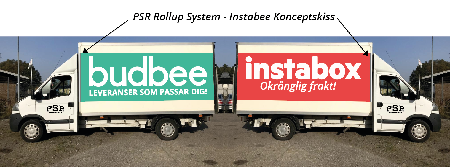

This is one of the changeable banner systems
