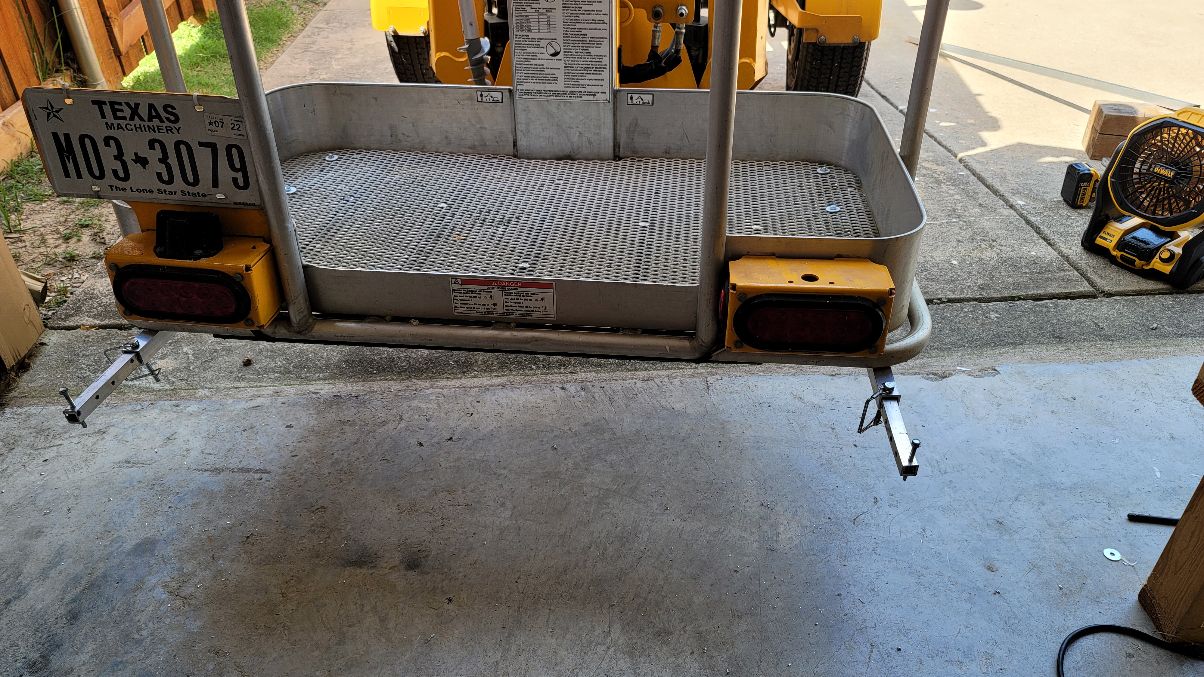

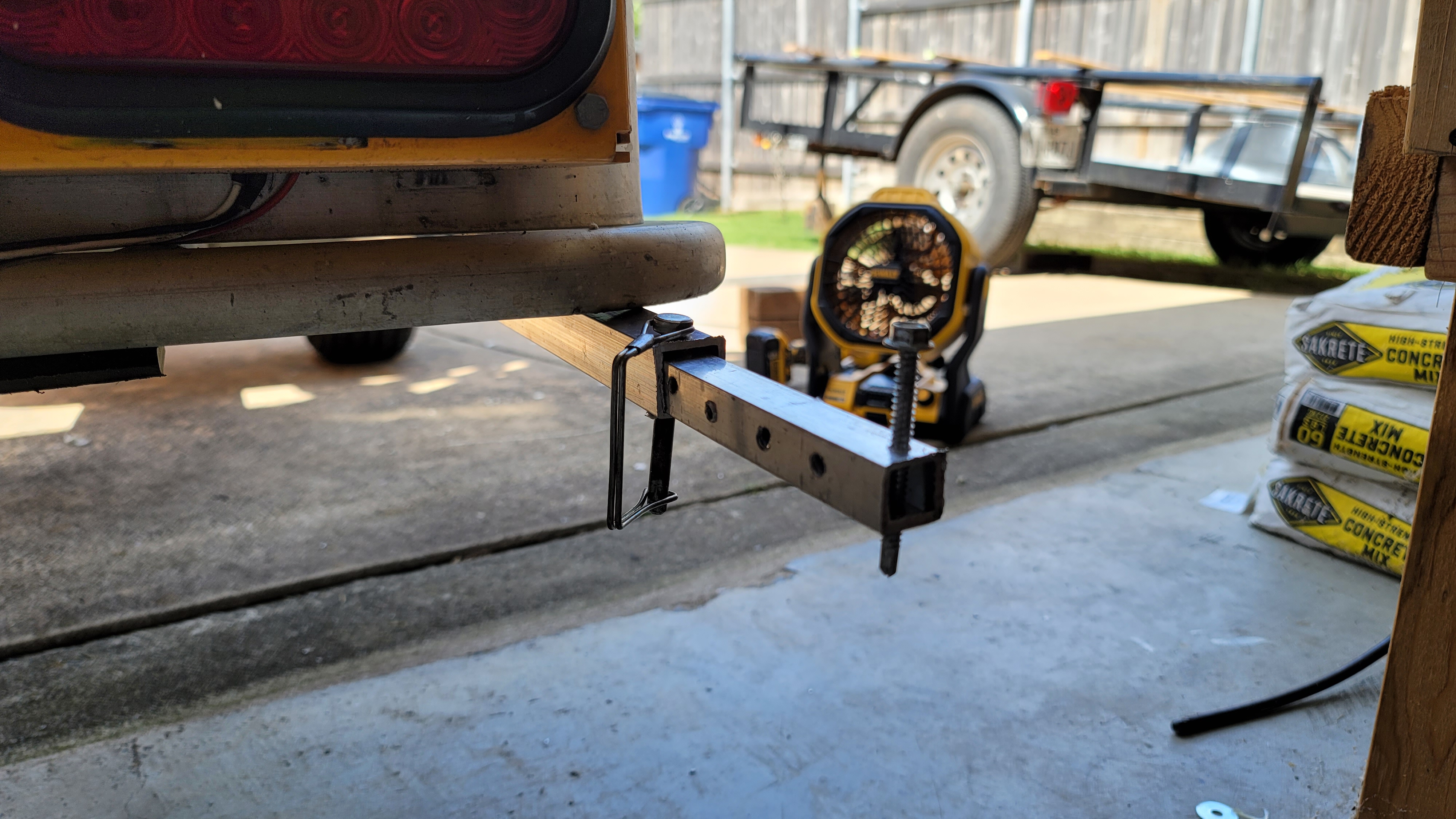

I have two square tube "forks" on the bottom of the basket that we slide faces out and rest them on the forks. 10' is nothing, even in the wind... especially with two people. I refaced an entire multi-tenant sign yesterday, 26 panels in total, half were 12'... in the pouring rain. Took about 6 hours total because some of them didn't fit correctly.

I also use c-clamps (only the older USA made Vice-Grip ones with the swivel pads) and clamp them around the tubes on my basket. 6 x 8 faces are not problem this way for one person and even larger with two people. The OP doesn't mention the height of the panels. I'm guessing these are in a multi-tenant sign so they can't get all that tall. Also, a pair of "duck-bill" vice-grips are very helpful in pulling the face towards you. irwin 8R IIRC.

I used to have a set of "Forks or fingers" I attached to the bottom of bucket or lifts. , could be C-Clamped on the front and ratchet strapped around and then I'd have straps and ropes to hold and wrap around whatever sign face your taking down. This was years ago.. I'm sure the legal restrictions have changed ,,lol

Tex what happened to your green lift - you trade it in for a yellow DeWalt model to one-up Mose?
