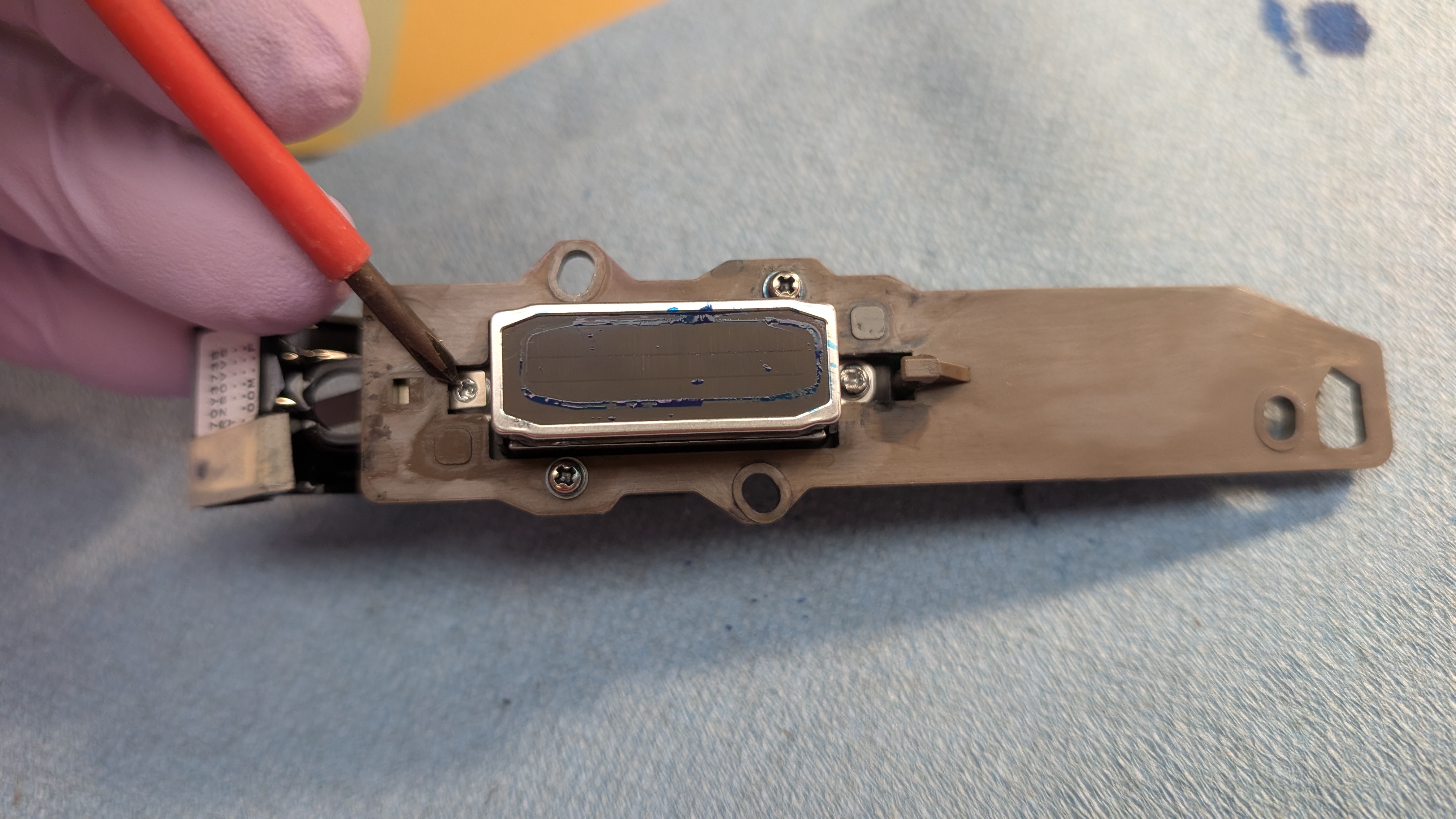

Is there a trick to removing the 2 screws that hold the print head and plastic manifold together? (see photo)
I broke one of the nipples so I bought a replacement manifold and I'm trying to swap it out, but neither of the two tiny phillips screws will BUDGE!
I tried every size phillips driver that I own, I've even tried using a flat blade that was wide enough to fit in the entire screw head, but when I went to unscrew it, the screwdriver blade actually bend/twisted!
I'm afraid to try any harder for fear of breaking something or stripping out the tiny head on this screw causing the entire head to be junk!! PLEASE.. any advise would be GREATLY appreciated!
PS, do I need to remove the white rubber looking stuff that's covering the hex shaped nut on the other side of the manifold? I didn't want to pluck that stuff out to see if there was a nut that could be removed because it looks important.
Thanks!

I have never had an issue, did one today.
I usually remove the brown base first.
You can remove the white rubber stuff, there is a nut under that, put a drop of cleaning solution from the nut side.
You may get lucky.

You absolutely must remove the printhead from the brown head adapter plate. It is physically impossible to remove the manifold screws without doing so. You might need to remove the nut with the white RTV from the old manifold if the replacement manifold doesn't have any. The best way to remove them from the old manifold after you have removed the manifold from the head is to put one of the screws into the nut from the bottom and push the nut out by putting pressure on the screw. No need to put cleaning solution on it, as the RTV will help keep the nut in place while installing it in the new manifold.

Thanks! I ended up destroying the head trying to get the two manifold screws out. They were VERY well seized in place by old ink. The heads of the screws are SO fine that the bitting quickly stripped out, so the ONLY chance I had of breaking them loose was to "slot" the heads with a dremel and a very fine diamond cutting disc, then using a flat blade screw driver. And even then, I had to apply SO much torque to the screws that the entire head NEARLY broke off one of them, and I was nearly spinning the nut around in it's hex-shaped pocket! When they finally gave way, it happened with a hard "POP" sound, and I found clear evidence of LOCTITE on the threads of BOTH screws! I'm 99% sure they were't supposed to be installed with loctite!
It occured to me that it was one of the heads that I previously replaced, and I bought that had from digiprint supply, so who knows how it got like that. It wasn't in a container sealed from Epson.
Either way, once I got it back together, It only partially printed the test pattern, and after several easy cleaning cycles, it quickly degraded until it was no longer firing any ink at all. Each test print would get worse and worse, until that entire color was gone from the test print pattern completely. So I either manhandled and damaged the head somehow when I was trying to break those screws loose, or some ink had dried/congealed in the time when the printer was down and I was waiting for the new manifold to ship (it sat approx 4 days without doing a cleaning cycle), and then after I installed it back in the printer, that glob of congealed ink moved into the manifold and completely clogged the head, or... who knows!
