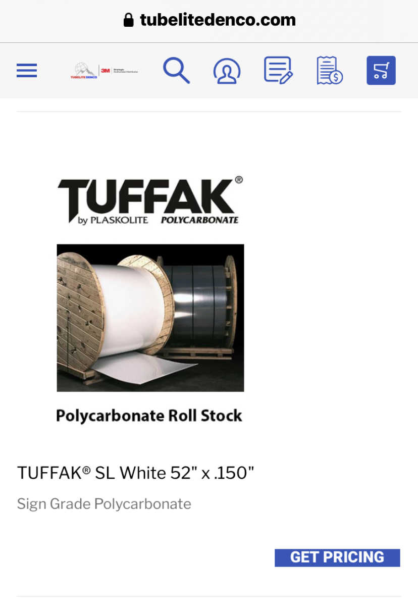

Roll stock fro tubelite

Assuming your profile is correct, if you are within Grimco's NJ delivery zone, you can just call them to order polycarbonate by the foot. They don't have it available to order online.
No matter which supplier you use, you won't likely find anybody who lists a 4'x16' piece online to order. They will list it as polycarbonate cut to length, and most likely you will have to call them to order it since it is a custom cut order.
