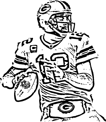

Ok I don't believe that will work for us. Maybe give you a better idea. attached is one of the stencilized photos. This is how the customer wants them but I need to get rid of all the really tiny stuff in the middle areas.

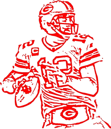

Actually I guess I didn't understand it when I read it the first time. I have tried it now and it works pretty good. You loose some of the definition. I attached the changed file also so you can see the difference.
I'd take it into photoshop and draw out the stuff you dont want - then do the outline inline approach. Illustrator also has a simplify path command if you have that.
