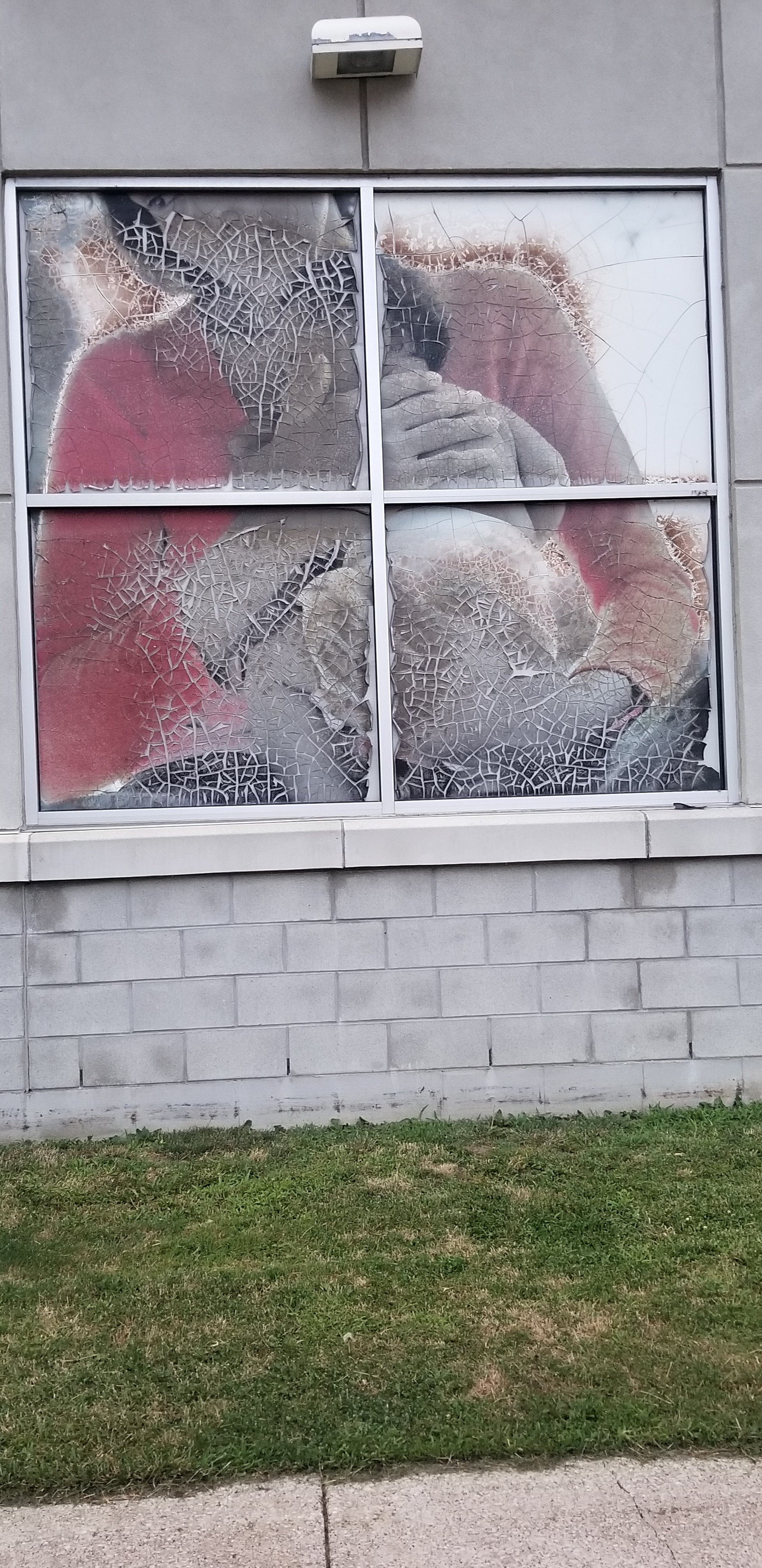

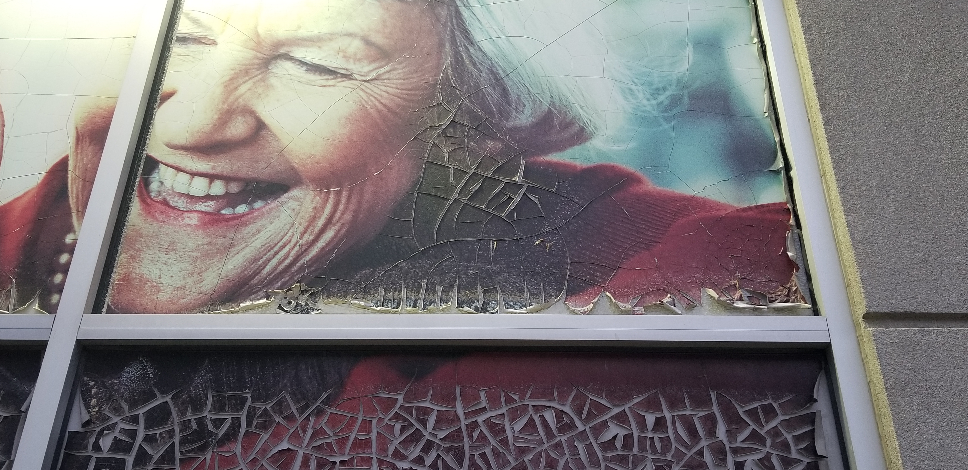

Hello Everyone,
We are just Removing cracked 212 sq ft window graphics and reinstalling, (vendor provided the graphics) . How
Much should we charge doing this project. It takes 16.5 hrs (4.69 minutes per sq ft )to remove and reinstall. Is there a better way to
Remove this graphics from the windows, we use 2 in razor blade with long handle and soft blade scraper for
Remove the glue using
Rapid remover and dish soap water mix.
We did wet application.
Thanks

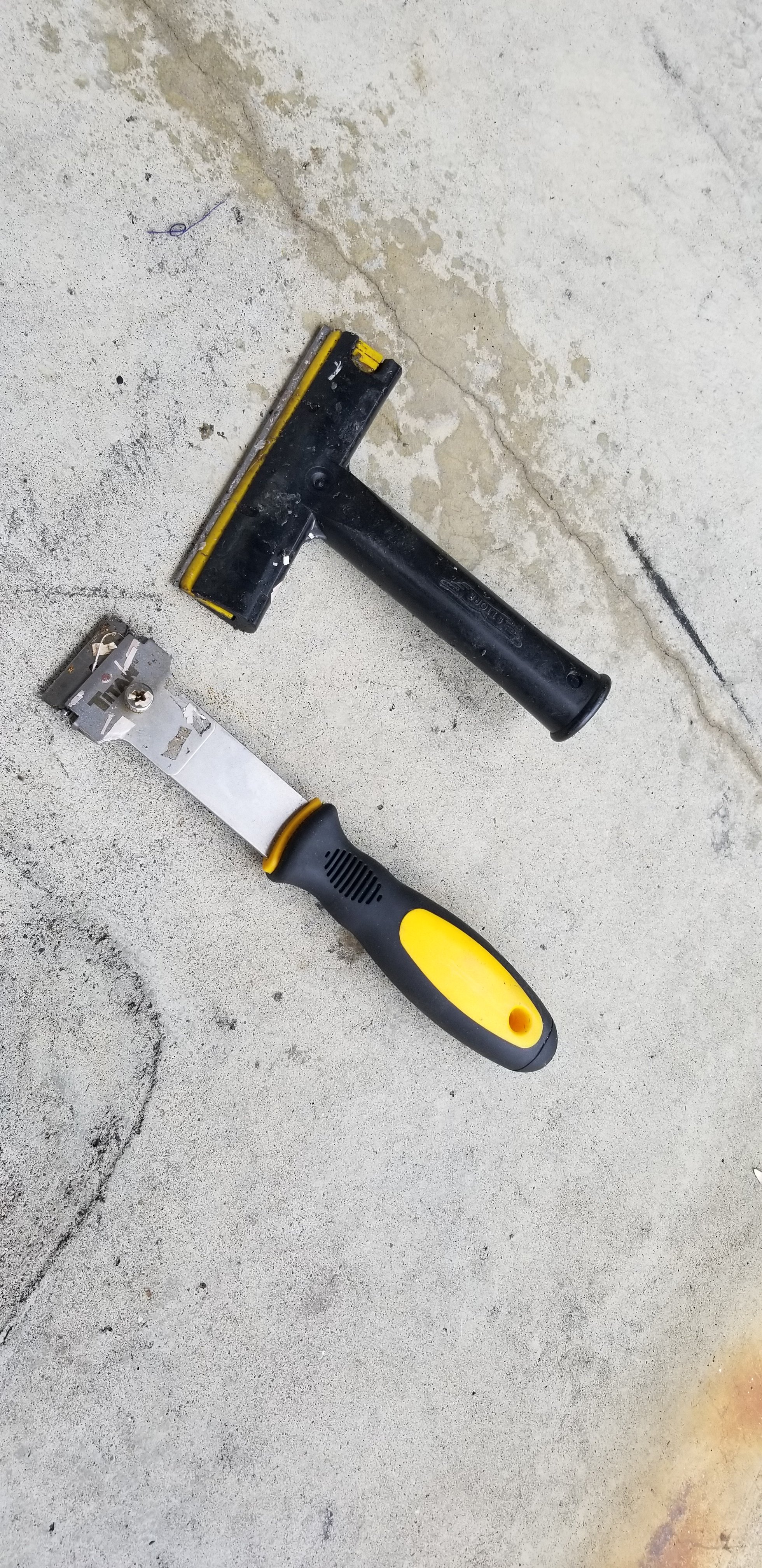

This are the razors I used , short one for
Removing the vinyl , long one for cleaning the glue after spray the rapid remover, and dish soap and water mix.

I'd be weary using that scraper, it says it comes with a carbon steel blade which can easily scratch or etch glass. Stainless steel is a much better option.
Did 28 windows at a resort hotel earlier this month without a scratch. I've seen people get plenty of scratches using standard 2" blades in the standard retractable holder because it lets the blade wobble and with a short blade it's too easy to dig a corner in. But if I had not been careful I am sure I could have damaged a window.
Sumon Sarker
This 2 blade not scratch as it leave glue in the window . Usually our windows are 2 layer , soft layer inside hard layer out side, I did install hard layer window
So no scaratch.

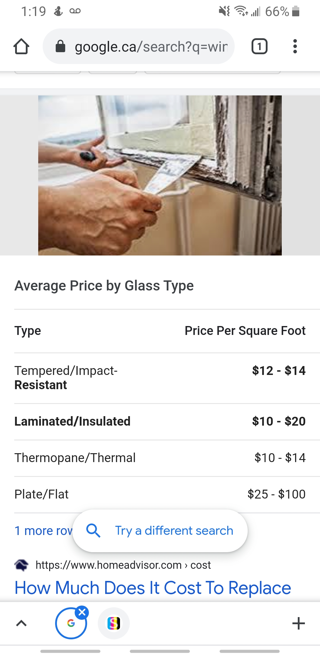

We are in Canada. It is range from 12 to 100 Cad per sq ft.
