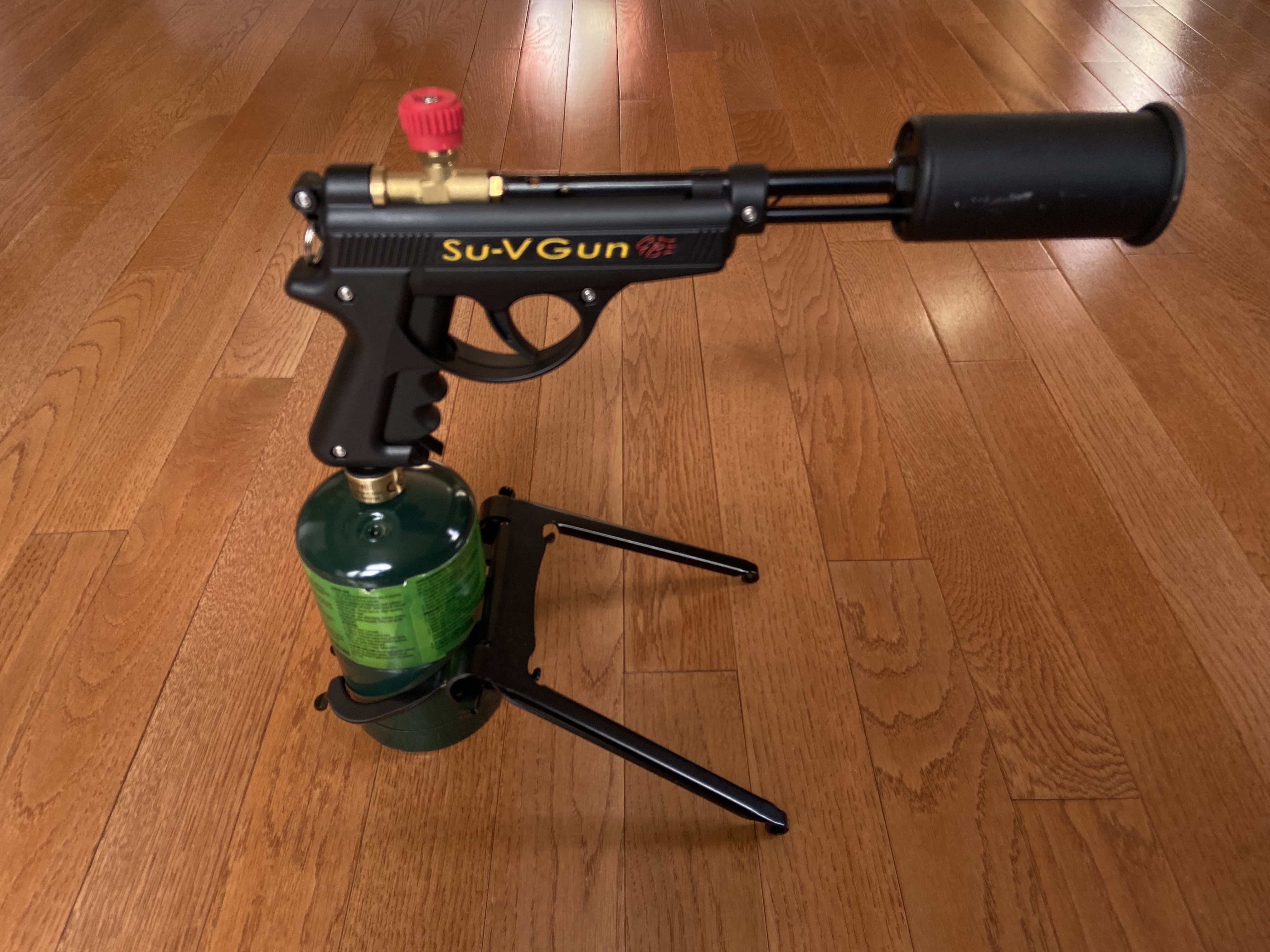

Never tried them but my go to is the larger Bernzomatic propane torch and Rapid Remover.
This one works well for larger graphics.
Brazing torch
