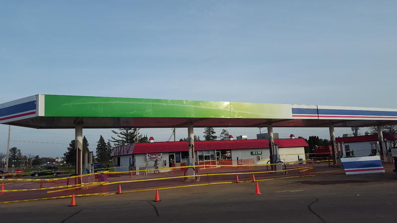

We are doing a series of acm signs that are laminated with Oracal 210 gloss. We are looking to remove scratches that were caused during installation. Any ideas how to remove them? I am wondering if buffing or frog juice would do the trick. Heat gun did not do anything. The signs look great until the sun hits them and really shows imperfections. Thanks in advance

Pete Moss
This photo should help...

eahicks
And since we can see what the end product is why in the world are you using 210? This looks like something they want to last a long time. I would have at least used 290. What vinyl is this?
Pete Moss
This job was quoted recommending 3951 with 290. The customer, against the companies input, wanted a lower price so it was made with 3165 and 210.
CanuckSigns
The vinyl should have very little impact on the cost of a job like that, your expense is in the install, getting the trucks on site to install those graphics safely. The couple hundred dollars saved in using a cheap vinyl will come around to bite them in the a$$ when they have to pay to reinstall the graphics in 1-2 years.
Some clients really can't see sense.
TheSnowman
Long as it's just fine scratches from a squeegee or something like that, we always torch every one that leaves the shop. You can tell where you've been because the scratches just erase as you go.
