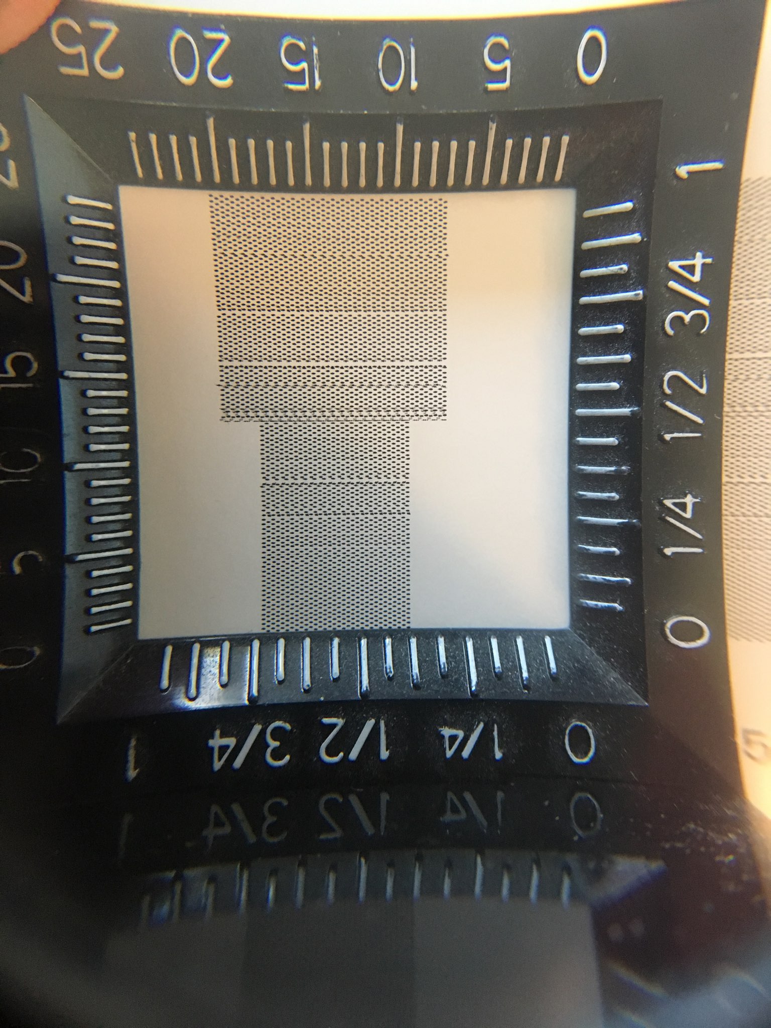

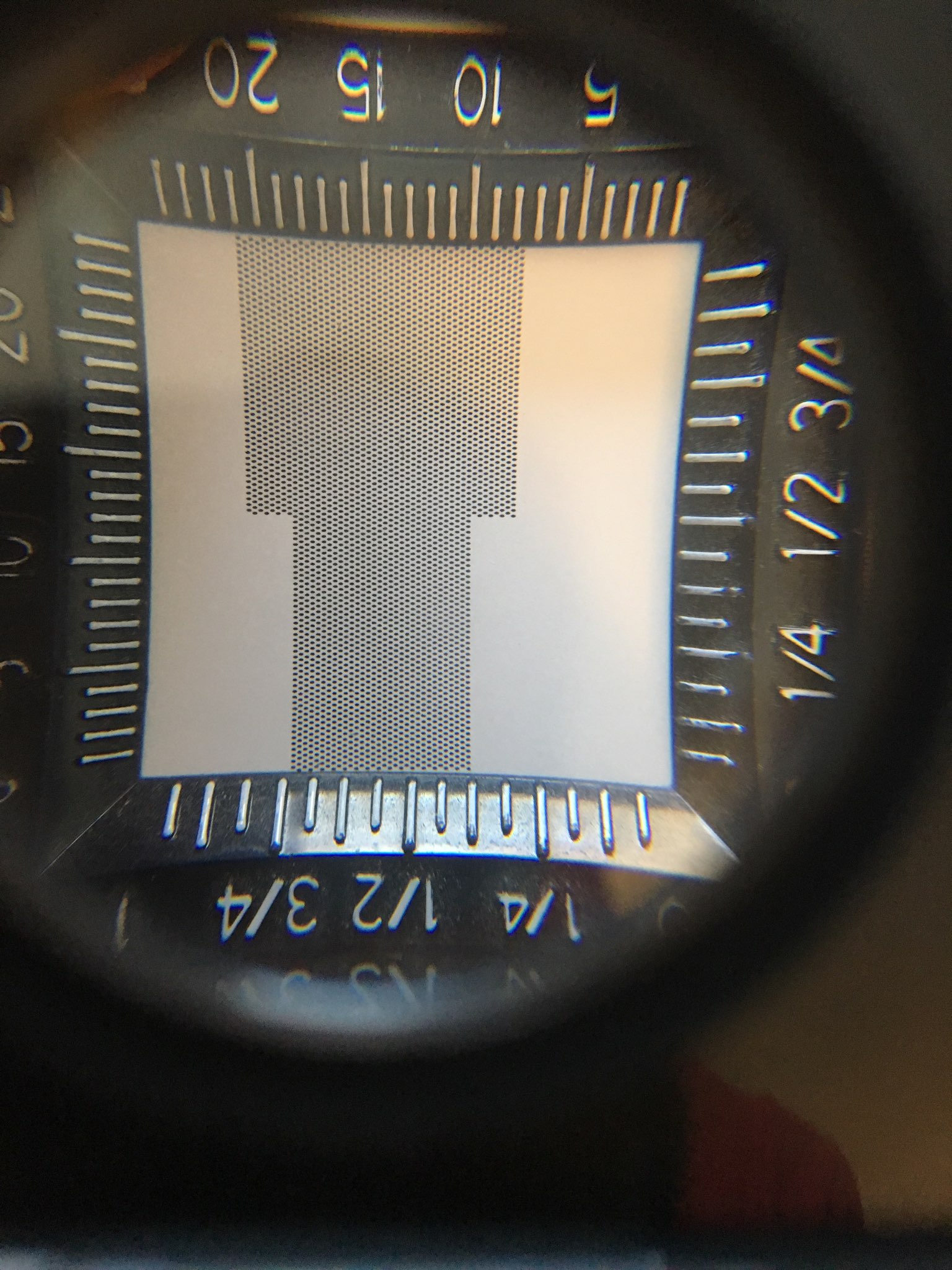

Well I swapped it out last night. Took a little longer than I thought. The changing the head part was quick, the head alignment and the rest of the stuff you have to do took a long time. What a difference in test prints it makes. Here are pictures showing the difference. Cant wait to print on Monday and see how the prints turn out.
