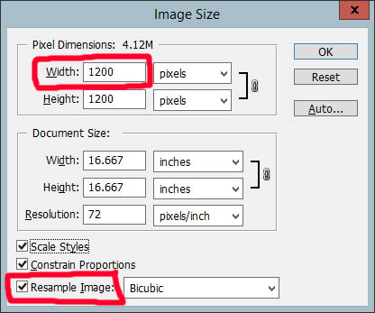

The method I spoke of is to simply increase the resolution of an image in a series of small steps upwards. For instance, if you have an image that is 1200px by 1200px and you need to get to 2400px by 2400px, you would open the image in, say, PhotoShop and manually increase the image size in increments of roughly 10%. (1200 to 1320 - then - 1320 to 1450 - then - 1450 to 1600, etc...... ) up to your desired image size (see attached). Make sure that "Resample Image" is turned on.
This works to a point and works the best when you are starting with an image that has already lots of size.
