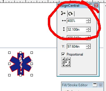

skyhigh
this

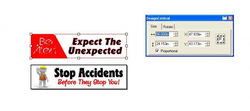

SightLine
In Flexi you can use percentages..... Just make sure propotional is checked. Then put the percentage you want WITH the percent symbol. Works fine - just enter the percentage in the width box like shown. This is in 8.6v2 if it matters but I think this still works in version 10 too.

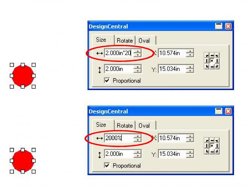

I felt compelled to give credit where its due. "Signage" showed me 2 ways to scale 1/20 up to full size in my older 6.7 software. The newer 8.6 has "percentages" right in design central (after you hit ctrl k), where as the older software has the capability, its not as obvious
Based off a 2" circle, there are two ways to scale up the 1/20 model
1) Top pic, you would simply add *20 behind the 2.000in........ 2.000in*20 (2x20)
2) Or, you can backspace out the 2.000in and replace it with...... 2000%
Either way gives me a 40" circle.
THANKS SIGNAGE....for showing me a couple new tricks
